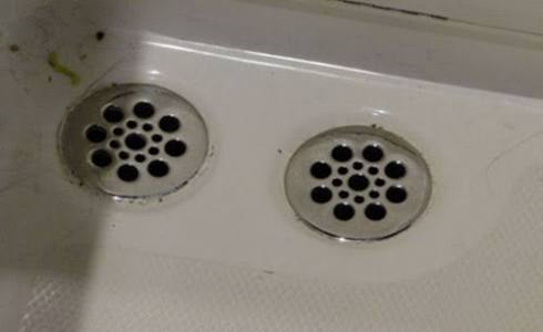

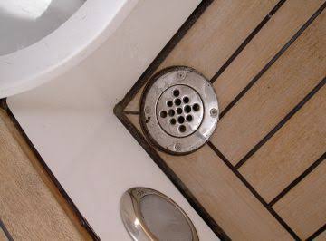

Most drains have a small screen on them to keep the muck away from the bilge pumps. They get blocked very easily. A few Google images, you're looking for something like these, likely tucked well away in the back corners, possibly under the lounge and out of sight.
RR

My cockpit floor has 2 drains in the back corners. I suspect somebody replaced your original flooring and covered the drains.
