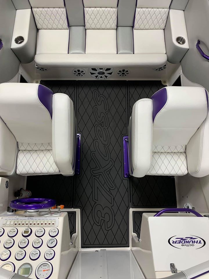

That is different than my 32 but my friend with the straight bottom 37 just had his interior done last year and it has the same side panels as yours.
Marine/Boat Upholstery ? HYTECH Auto Trim ? Automotive Upholstery, Window Tinting ? Car and Truck Accessories did the work.
That's a damn good looking interior. It appears they removed and installed it without making new access holes. Encouraging.
It also appears that his "Loincoin" floor has also stained. Which boat is this? I think there are only 3 37' straight bottom boats. Power??
I think there might be 5-6 straight 37's. It used to be tfarmer's boat and he bought it from Fastboats. Anybody Looking?
My friend Geno bought it from Timmy almost 2 years ago. It wasn't listed at the time, but had been about a year earlier so I put them in touch and the deal got made. It has the original 500efi's with about 300hrs now. The floor was redone with seadeck like stuff right after the interior. Our slips at our LOTO condos are right next to each other.
