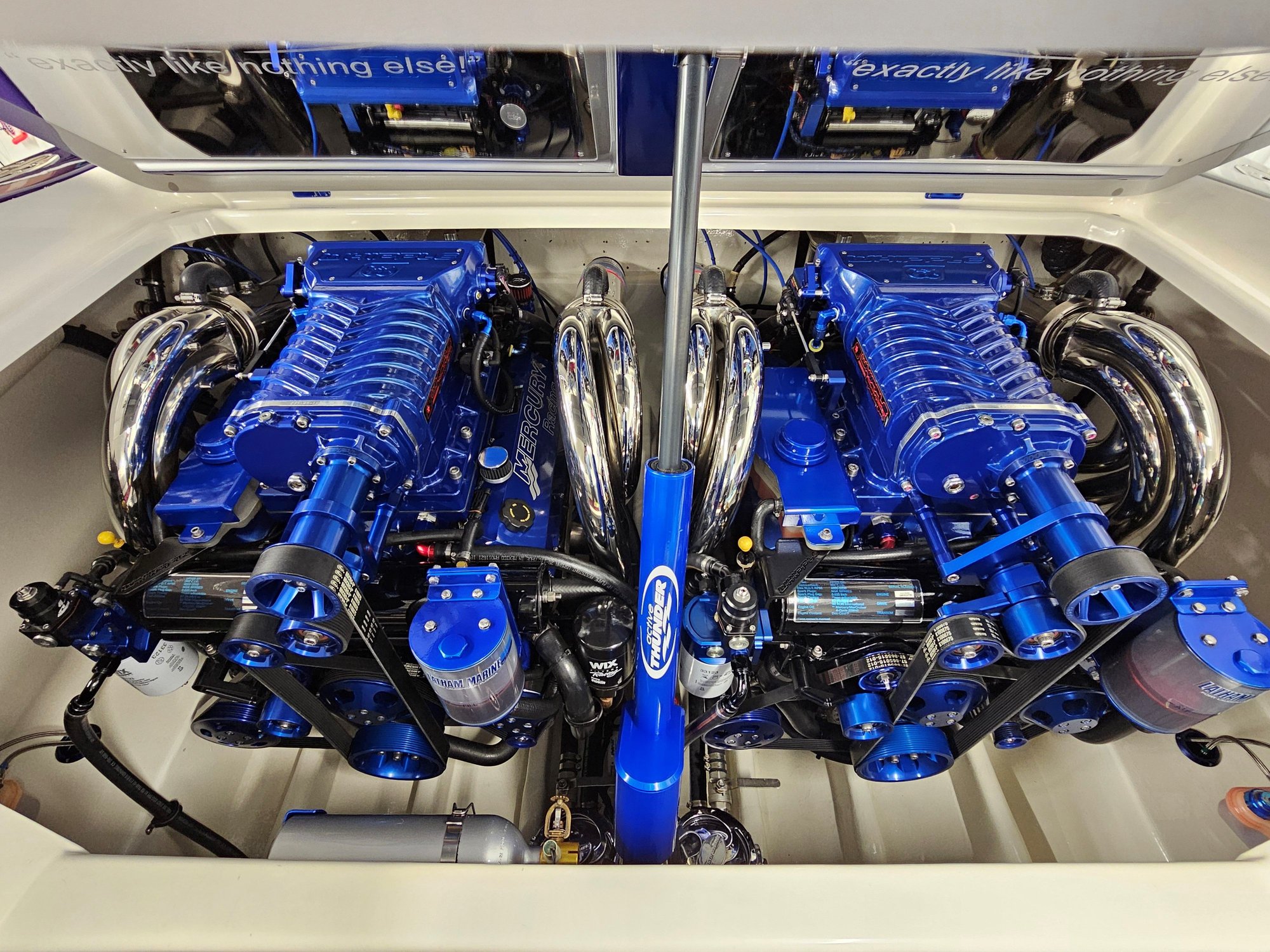

Finally got around to getting all the fluids changes and the Whipples serviced, also added the brackets with idler pulleys to keep tension on the blower belt. Thanks to Dennis @ Whipple Superchargers for taking care of me on getting the new idler pulley setup. Also removed the gen 5/6 sea pumps that had the fuel pump provision and replaced them with the gen 4 Hardin Marine sea pumps using their mandrel so I could use my factory sea pump pulley.

I'm in the slow but sure process of converting my motor over to a serpentine setup instead of the 3 v belts. Good to know that the Hardin gen 4 pump with their mandrel will work.
Did these start as 525's I assume?
Were you able to use your stock water pump brackets with the gen 4 pumps?
Thanks! Looks AMAZING!!!!

Thank you and yes, mine are 525 EFI'S. Using the Whipple set up on the 525's, the mechanical fuel pump gets replaced with a block off plate. I was brainstorming the idea when I got the calipers out and measured both pumps. The only difference was one had a fuel pump provision, and the other did not. The only thing needed to do was drill out the mounting plate holes due to the Hardin pumps being threaded internally whereas the Mercury pumps are not. I think this setup is a cleaner look now.
