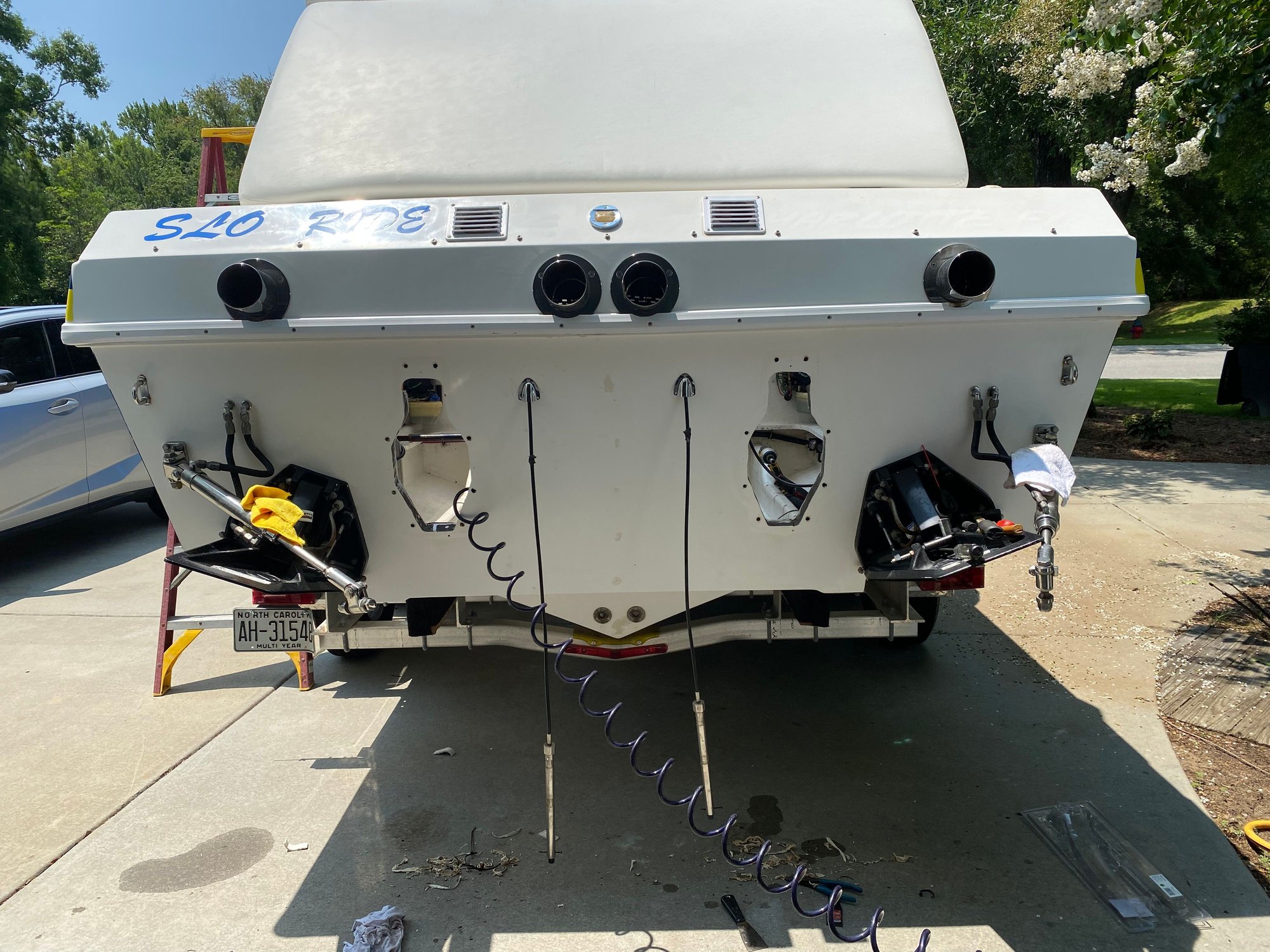

Hey thought I’d share some back/gelcoat saver. Do to major corrosion on the Transom assemblies I had to replace them. Come to find out someone applied 3m 5200 on the housings when they were installed. If you don’t like to repair fiberglass like me you’ll want to know about “Marine Formula” by Debond Corp.
follow the directions take your tome and the stuff peels right off. Thank Goodness.
