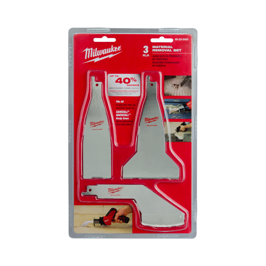

I agree with Griff. Use an oscillating cutter tool. They also have "putty blades" (my descriptor) that you put in a saws-all for removing windshields which you might be able to use.
Attachment 577297
