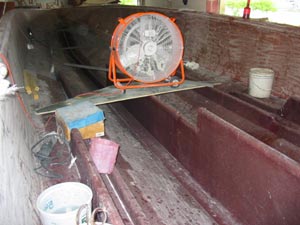

9, then 4, then 3+ cabin stucture bonding and foam.

And you can see we double up the widths over the step area plus lateral gussets.

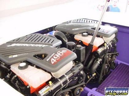

Interesting shot in #18, appears to be some type of horizontal gusset off the front bulk head. Am I correct in my interpretation? I have seen a number of manufacturers that go with a perpendicular gusset between stringers in the engine compartment, or under the engines, but this appears to be unique.

Those gussets supports the Composite-Diamondplate in front of the motors.

I thought it might be to support diamond plate also. I had to take 2nd look as I could not figure why you would gusset at the top of the stringer. Wasn't sure if Active Thunder had a unique approach or reason. One of the reasons why I like to see how a particular brand is constructed. Never know when I may be shopping for a new ride. I like to keep a short list of possibilities.
