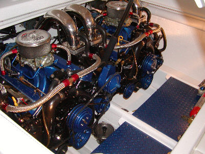

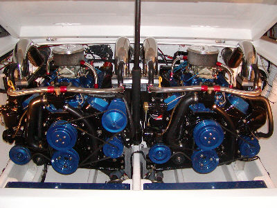

First the motors were pulled out and completly torn down, each part was stripped and re-painted and then clear coated.
The motors were bored to 30 over and compression raised 9.75 / 1 , Nothing but the best parts went into this rebuild,
AED Carbs, Crane Cam, Rollmaster Twin Timing Chain, Crane Lifters, Melling Oil Pumps, SRP pistons, Total Seal Rings, ARP rods bolts.......Everything was balanced, heads ported and polished, intake port matched.
Bilge was painted with Bilgekote Paint.
Attached Thumbnails Winter Projects Complete-p3310001.jpg   Winter Projects Complete-p3310003.jpg

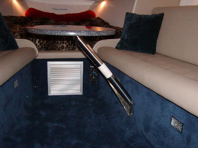

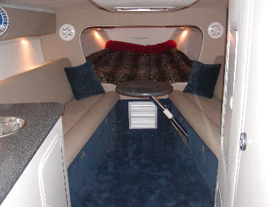

Next project, Was the cabin, everything was pulled out and recovered in Tan Ultra Leather, the v-berth cushion, added 3'' of foam, for more comfort. Bulkhead was done in two-tone, with a white accent center part. Also built a custom cabinet for the wife to do the hair & make-up thing.
Attached Thumbnails Winter Projects Complete-p3310004.jpg   Winter Projects Complete-p3310006.jpg   Winter Projects Complete-p3310014.jpg

Nice job on the cabin! The table has perked my curiosity. Got a better detailed picture of the mount?

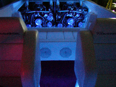

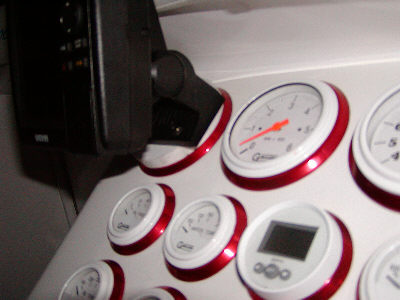

Now for the electronics, 12'' Faltscreen TV with DVD player,
1500 watt power inverter, for the blender on hot days, 2 more 10'' Babbs installed under the rear seat, two 8'' Pioneer's, with four 6'' Pioneer's and four MB Quartz tweeter's , powered by 3 Rockford Amp's.
Also intalled four street-glow neon lights, two under the bolsters & two in the engine room.
One Garmin 182C GPS on the dash.
Attached Thumbnails Winter Projects Complete-p3310007.jpg   Winter Projects Complete-p3310009.jpg   Winter Projects Complete-p3310011.jpg

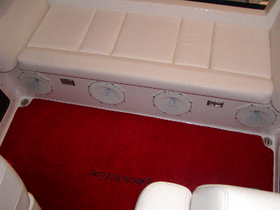

Four 10'' Babbs

Had Mat Works make a custom drop in carpet, and made the wife a custom seat cushion for more support.
Made a custom stainless corrian table support.

Thanks Pat, we love our boat!!!
Sure , I can tell you what I used fot the table, but you have too promise not to laugh.....
It is two of the stainless rod holders that slide into a bracket.
I did not want a hole in the center of the cabin floor, most of them my wife's foot would have fell into. She's Blonde....
Then on the bottom support welded a brace and connected the two with a piece of pvc pipe. The nice thing is that it will fold up into small parts for storage.
Will get pics soon.

Thru-bolted to the stringer?
