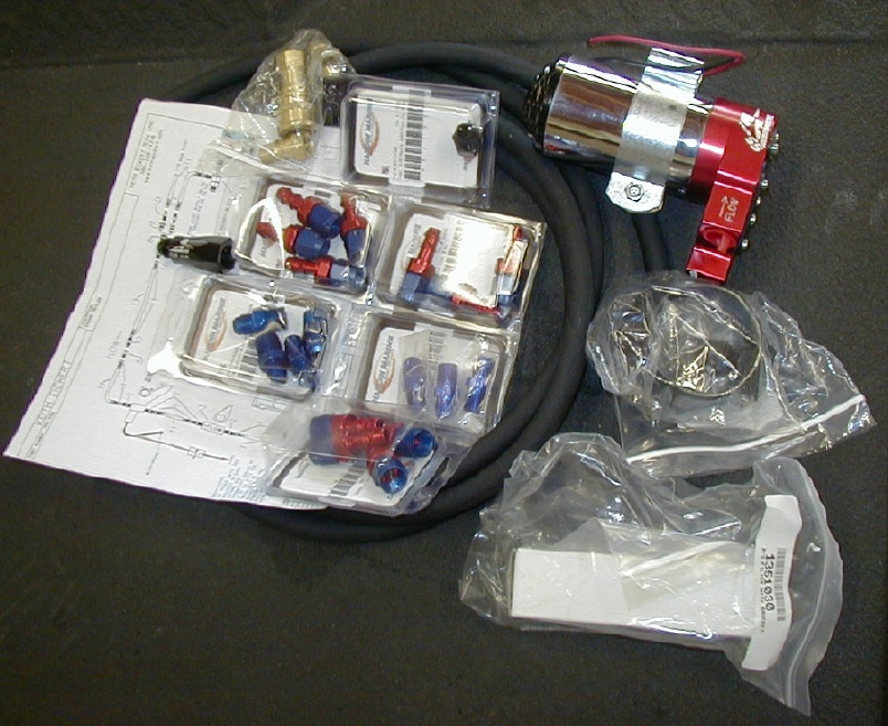

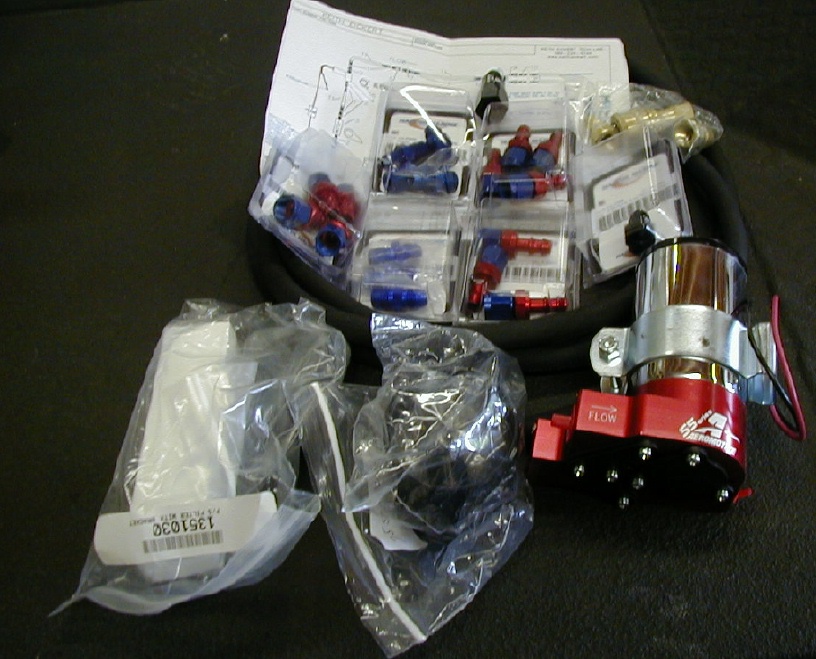

I just looked through the Eickert web site, but I did not see their pre-lube system. They had only the Master Lube system on there from what I was able to find. I don't know why their system is in the catalog, but not on the web site. Anyhow, here are two pictures of the system I got from them with the part number mentioned above. This is what comes in the box for each pre-lube system.

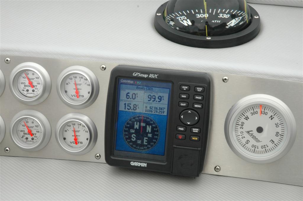

Heres a pic Jim took on the South Haven trip. Notice the max speed, ouch, so close.....................

Thanks for the info Wil. I am actually putting my own together because my pans were already plumbed for an oil change system. I am running the same Aeromotive pump. All I have to do is hook up the pump and plumb the return/pressure side. Does the Eikert kit include a filter as well as a check valve to isolate the pump when the engine is running?

The Eickert kit does have a filter and a check valve to prevent oil from flowing the wrong way. They also include a quick disconnect fitting for the hose leading out of the pump going back to the engine. This will allow us to disconnect that hose and connect a long hose going out of the boat so we can use the pump to change the engine oil. It is a nice setup. Like the other stuff though, there isn't any reason why you can't get the fitting and do it yourself.
