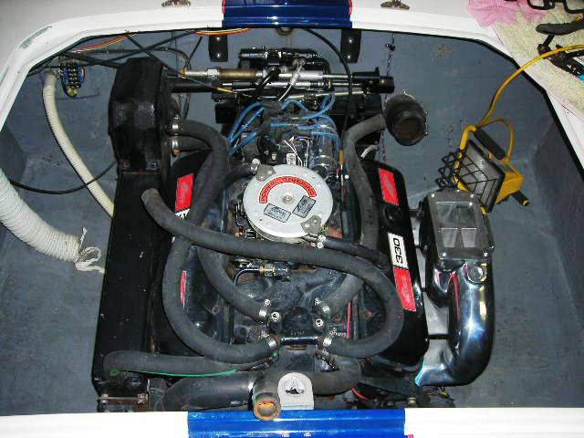

Default Re: Houston we have a problem over !!!!!
Been just kicking around, slow as hell at work. I'm currently swapping exhaust in Debbie's 22 Donzi.
