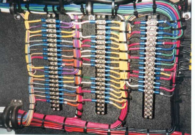

I have one that tells what all the wiring in the blocks are behind the dash for a 1997, but its at the lake. If yours looks anything like this?

All the wiring is numbered, you should be able to follow the numbers from the fuse panel to the dist. block to the switch to figure out which one it is.
But as others said, give Bobby a call!

Thanks Guys. Yes it is numbered and it is the #7 fuse on mine that keeps going. I will be back at the lake in a couple weeks and that is going to be my Sat. A.m. project. I will follow it back and see what I can come up with. I am also going to hook it up to a breaker so I don't go through a bazillion fuses in the process.
