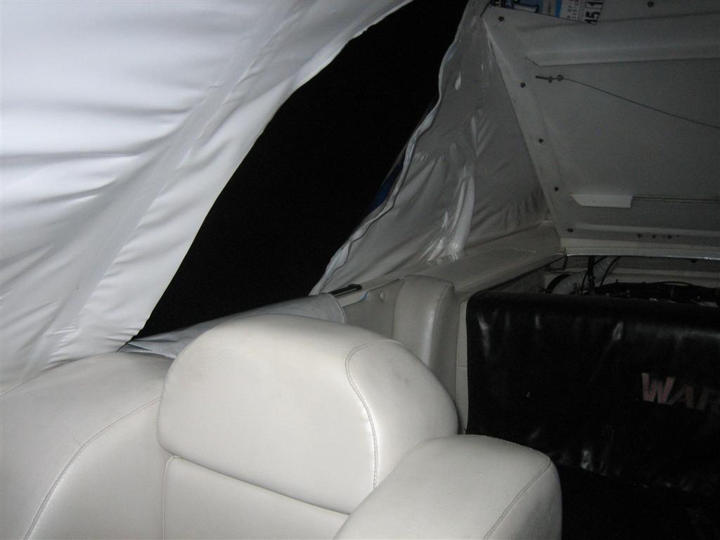

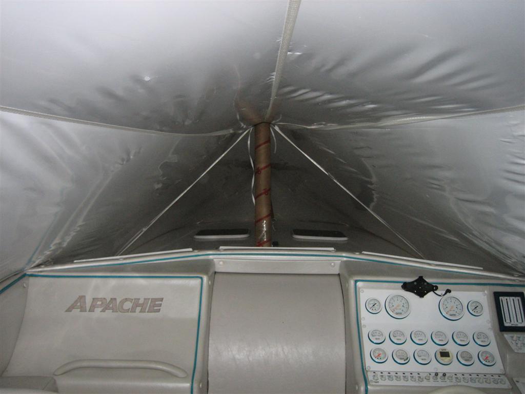

BUT, I was surprised to see a tarp over that beautiful paint job you posted so many pics of. If can make you a hangar out of Shrinkwrap, you can call it Ft. Comanche.... Much cheaper than a garage and can put in a 10 ft door, whatever you want. I did one for a 37' OL on E. Road a few years ago. $10 ft.
