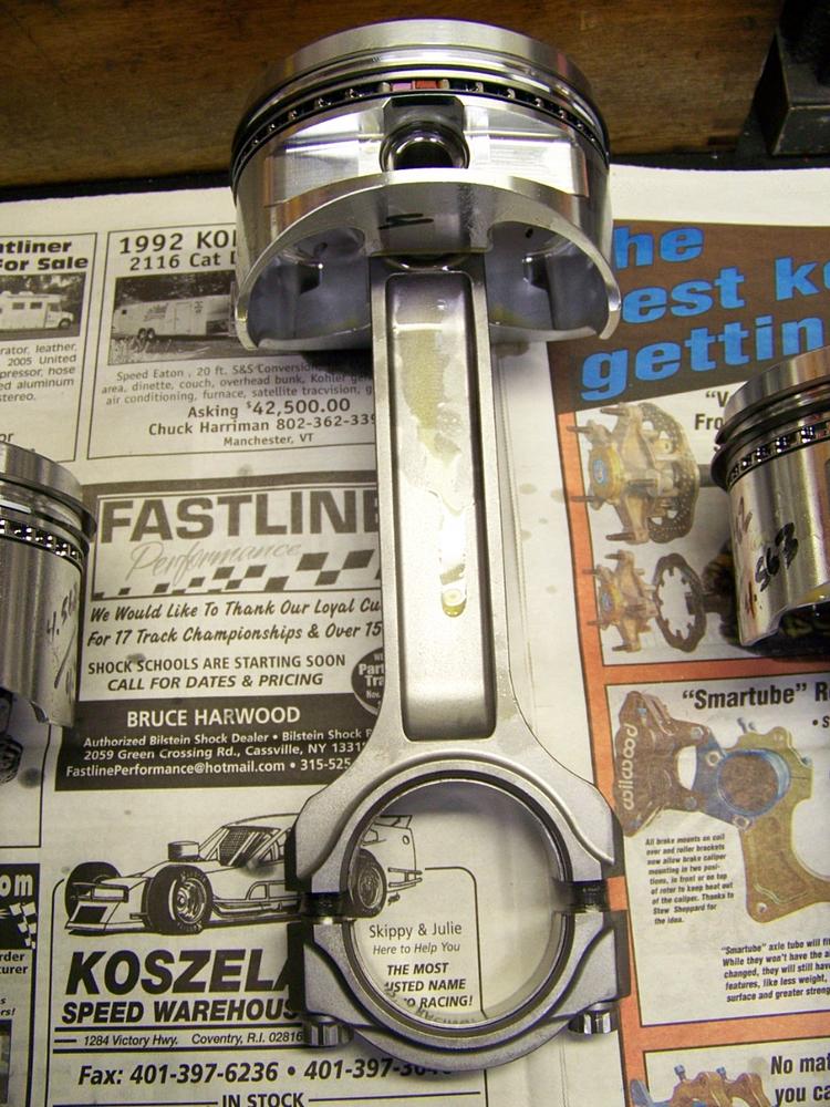

Some photos of the custom rods.

Just curious, if you put new pistons in, why didnt you go with a 6.7 or 6.8 length rod that is relatively standard on the tall decks.
What is the bore and stroke combination?
If memeroy servers me, Zull built a few of these 653 cubic inch. Makes lots of power but durability was very poor. LT

Originally Posted by mrhorsepower1
7.750 center to center It was either Carrillo or Crower to build them .Carrillo was way more money, we went with Crower.
Its a shame you didn't order the rods when you disassembled the engines. Ordering long lead time parts last is a smart play.
They are 656 cu.in. with 11.625 deck. thus, the long odd ball rod length.
