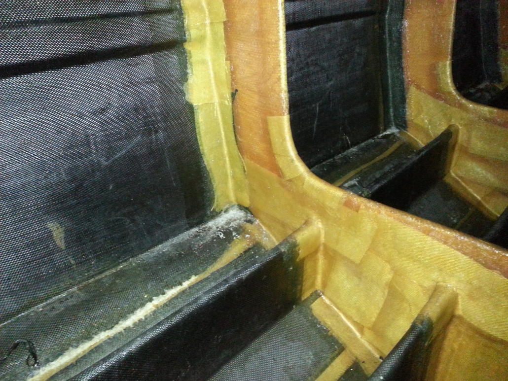

here is the cuddy of midas

Originally Posted by nate
I was under the impression that only Sam, Tatonka, Geronimo, Ghost Runner, and Tonto were carbon boats. Midas was too??
Yes it is And a different stringer arrangement under the deck.

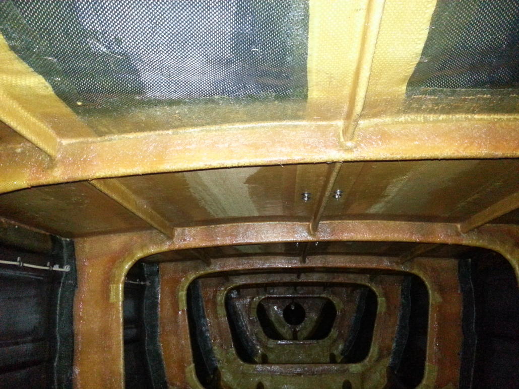

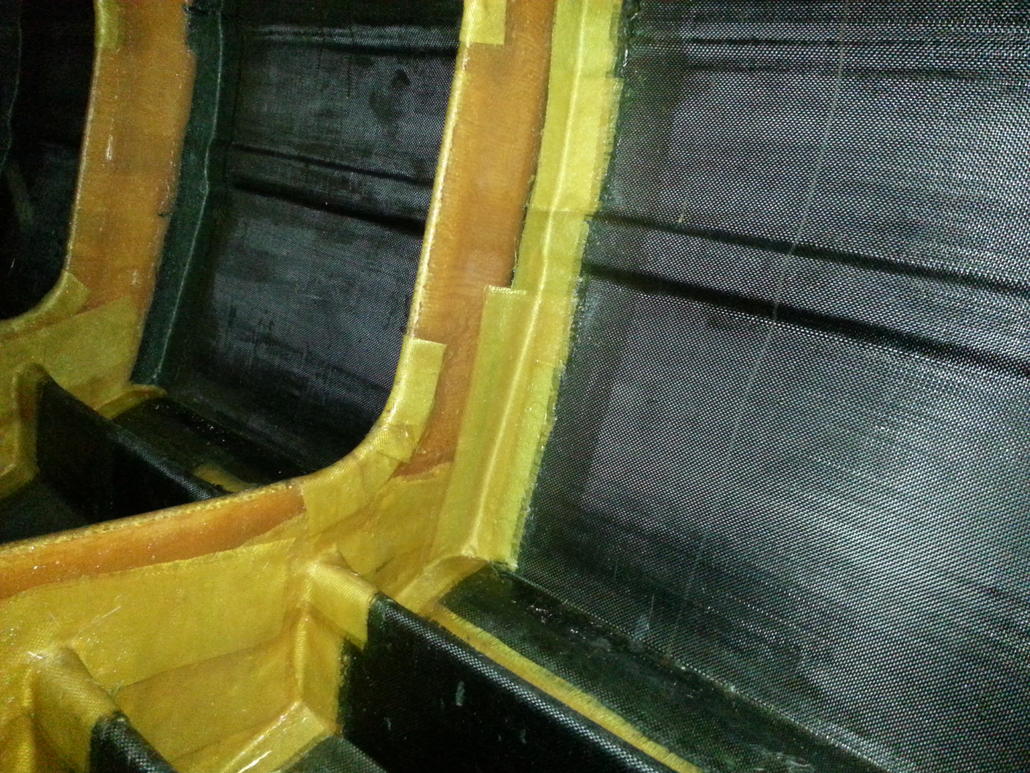

[ATTACH=CONFIG]533425[/ATTACH][ATTACH=CONFIG]533426[/ATTACH]
Attached Thumbnails Weight of a 41' Apache?-166.jpg   Weight of a 41' Apache?-170.jpg

the earlier apache had extra bulk heads around the middle of the boat near the wind screen area. the later ones don't have that and you will see cracking on the deck and if it isn't addressed sooner than later it will run down the sides of the boat too.

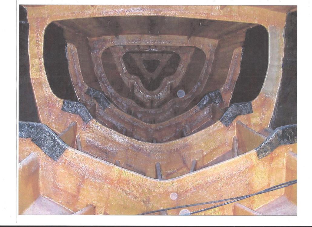

Star Chaser scanned picture.
What year are you calling early? Midas could use more bulk head at the base of the wind screen to deck area.
