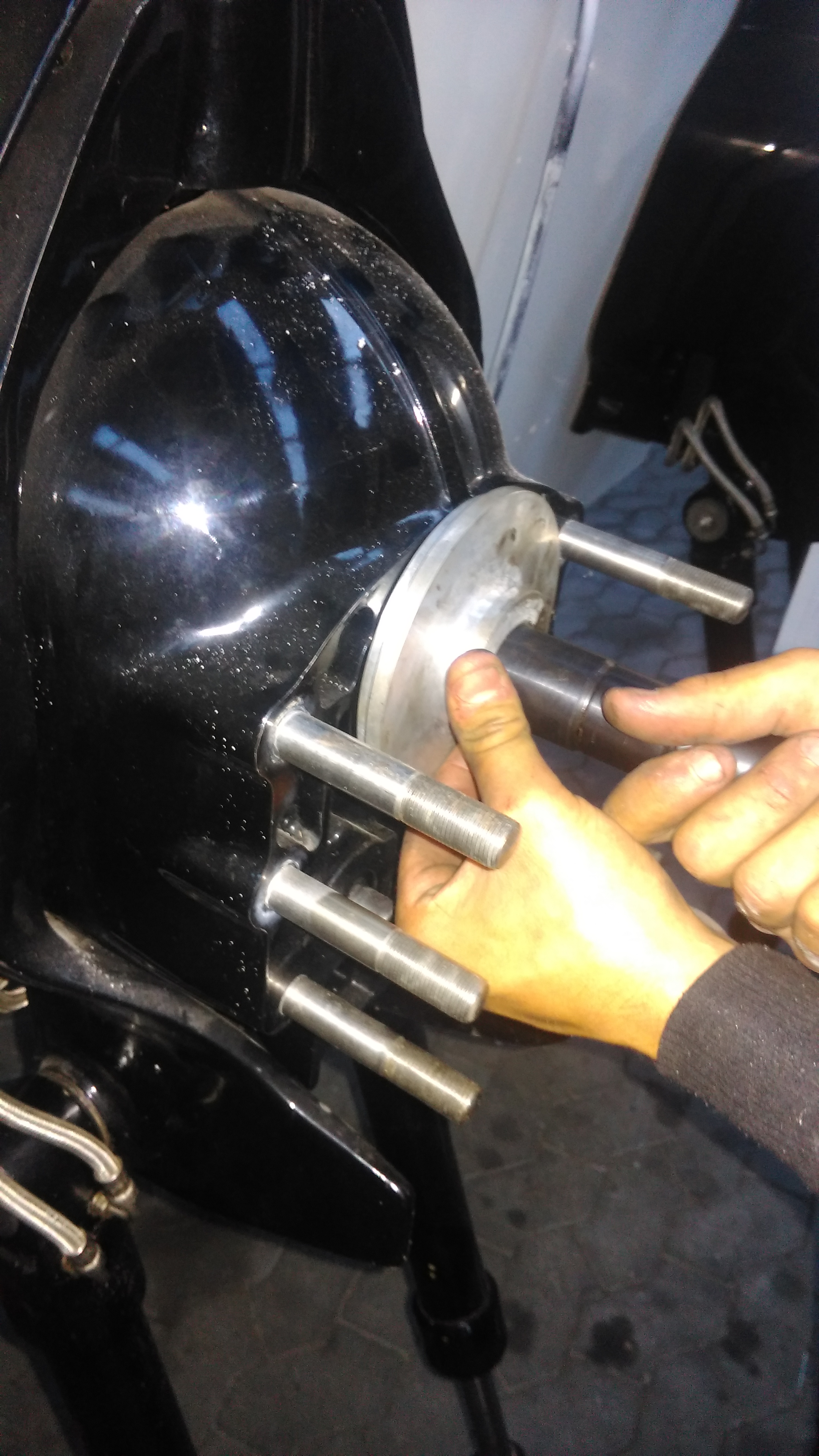

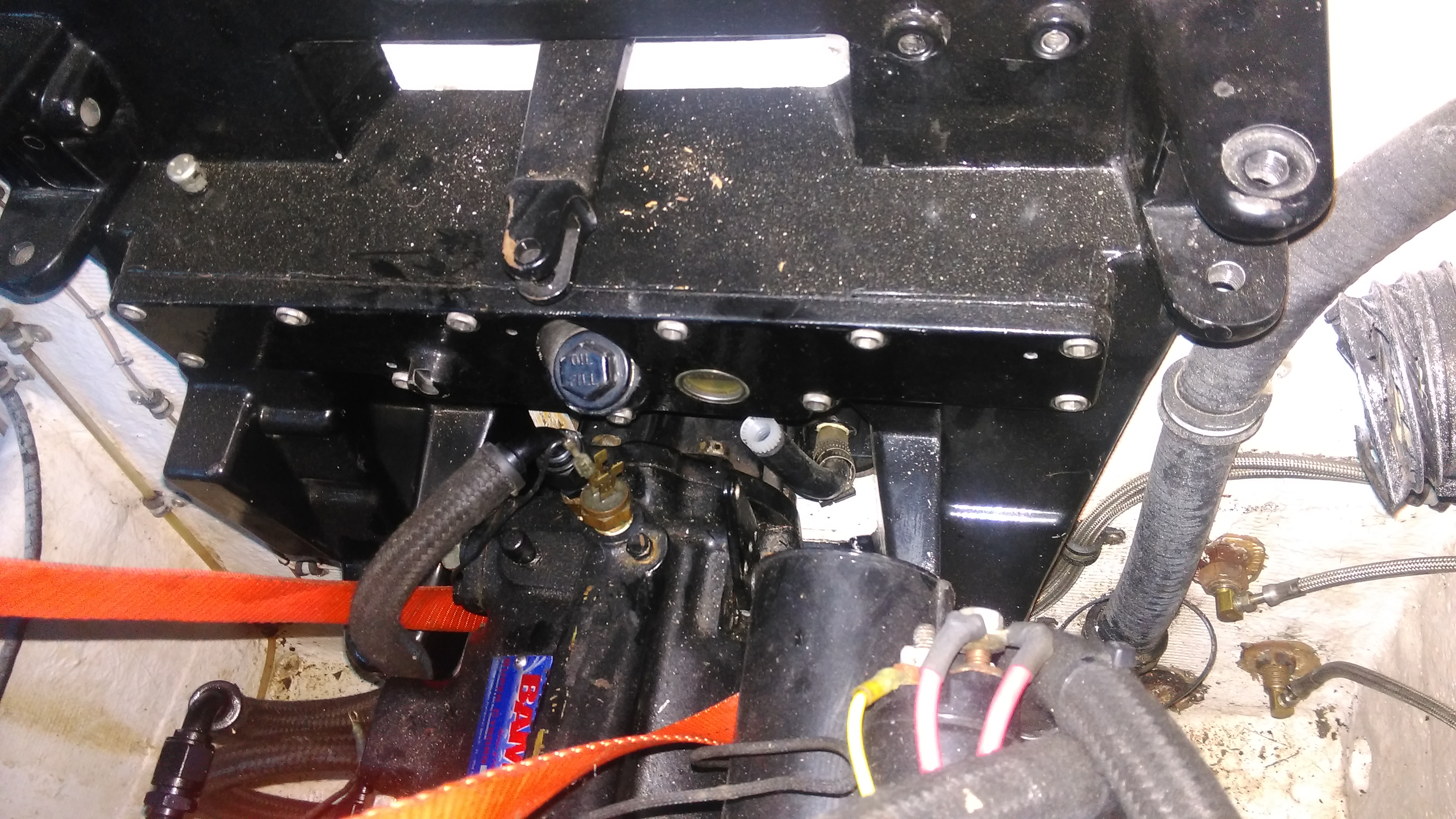

Hi Guys Things are going a Little slow here.. have one engine in for checking wireconn to dash etc..have a couple of ? how do I get the engine trannie all the way in..have a hard time levelling it up?does my way of the alignment seem right with the tool? and last the old holes are a little higher for the exhaust , hate to make new holes any ideas to move my exhaust 1.5-2 inch higher up..spacers? open for ideas..on the pic from inner trans there is a small black hose with a White cap on the ..whats that for..oil in the inner transom whats that for..I know I have a lot of stupid quistions..sorry..just wanna do it right the first time..thanks guys

Originally Posted by leif
Hi Guys Things are going a Little slow here. ...oil in the inner transom whats that for..I know I have a lot of stupid quistions..sorry..just wanna do it right the first time..thanks guys
The black cap that says "oil fill" is for toping off the out-drive fluid and to the right of that is the round sight glass to see it full.
If you have gill style manifolds you can add wedges to raise the exit point on the pipes
