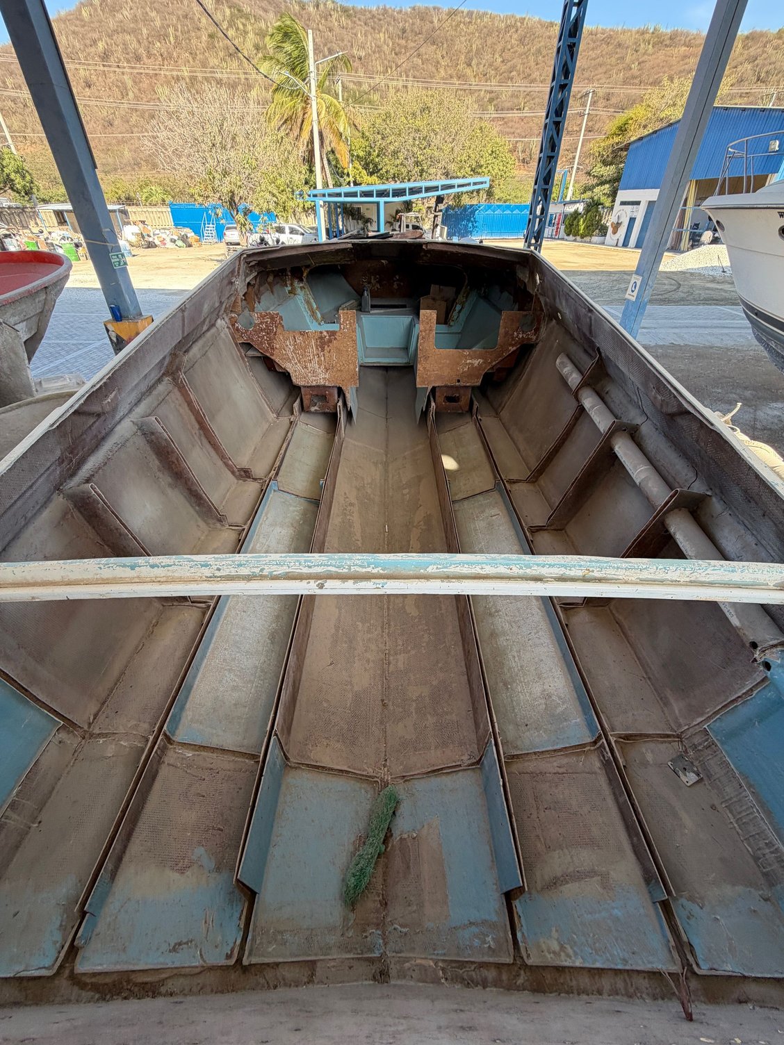

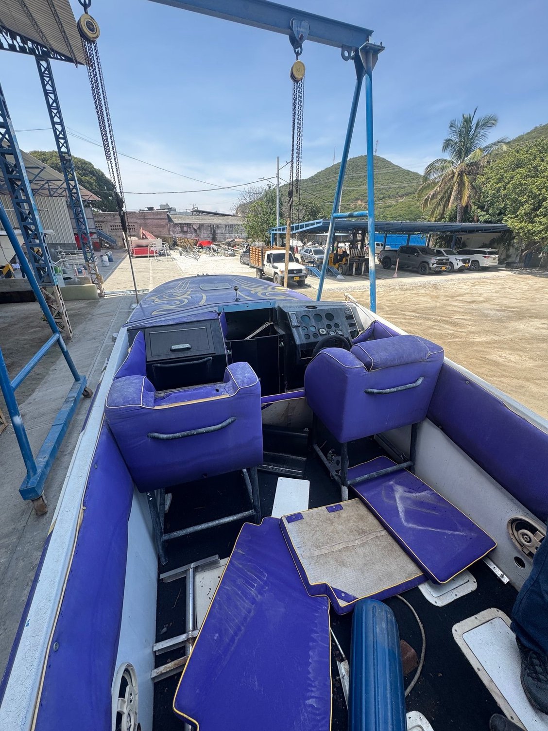

i live in colombia. Last year i bought an apache 28 that had been sitting in a boatyard for years without engines or anything, just the bare hull.
I started the restoration lat month. Ordered a pair a new mercury 400rs from the dealer, with the sportsmaster lower ends.
The actual boat appears on a apache ad from the 90s (bottom right corner in the image i uploaded).
We have a local race in july and my intention is to have this boat reach the highest top speed possible, and what i`m wondering is if it`s a good idea to add a pad to the hull?
Or will that risk screwing up its performance? The seas here are not calm at all so maybe having a full vee would be a better idea?
