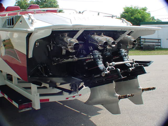

Anyone know this boat or its history? It is for sale by a guy named Tom Gentry.
The boat is supposed to have original gel coat and paint, and C&G 572'2 naturally aspirated (one has 60 hours, other has 120 hours) and rebuilt #3's with 40 hours.
The name is "subtle approach"
Attached Thumbnails 41 Apache in Grand Haven MI-apache41side1.jpg   41 Apache in Grand Haven MI-apache41nose.jpg   41 Apache in Grand Haven MI-apache41transom.jpg

i went to see the boat 2 days ago. i think he said there have been 4-5 owners, he having owned it 2 times. i know that it has been in connecticut at some point in its life. i can barely make out a port of somwhere in CT on the transom from a prior painting. also i can read "painted by benny" on the side towards the back. everything looks to be original as the owner said it was. original gel & paint work, interior, engines & drives[all rebuilt], & a new trailer. we did not go in the water or start the engines, because we were all on a short time schedule. also the fairing is off & he is making a new one that is more laid back. so here are my questions:
1. anything on an apache that is a problem area?
2. how do i ck the fuel tanks to see if they are leaking or have been repaired/replaced? the fuel tanks are under the floor i assume, none in the engine comparment. this seems to be an area of concern from what i have read on OSO.
3. how do i tell if the engines are really "C&G"? not some backyard rebuild shop. he suggested i call "Randy" at Cobra & he will verify everything.
4. what do i listen for or feel on the 3a drives? they are the large prop shafts. if we go forward & reverse it's OK?
5. any "apache" things that should be here like, the plaque in front of the passenger on the dash that says "national & world champions" with the indian head in the center. there's also one as you walk into the cabin on the left next to the radio of the indian head. anymore?
any suggestions or thoughts will be greatly appreciated by us. i really don't want to make a huge mistake here. boat looks real good, but looks sometimes are deceiving. thanks for all your help.

All 41 pleasure boats have to have there tanks replaced, plane on 5 to 10 grand.3 A's are a great drive make sure they have not been switched for 3. With your hand on the prop spin it back and forth if it fells smooth you maybe okay if you feel any any problems you will have to have a rebuild and maybe a new gear set. $$$$

What is the easiest way to tell a "3" from a "3a"?

The propshaft on the 3 is smaller than the 3A

3A's have the same prop shaft size as a #6 which good size.

If they weren't side by side, how could the unfamilliar tell?
