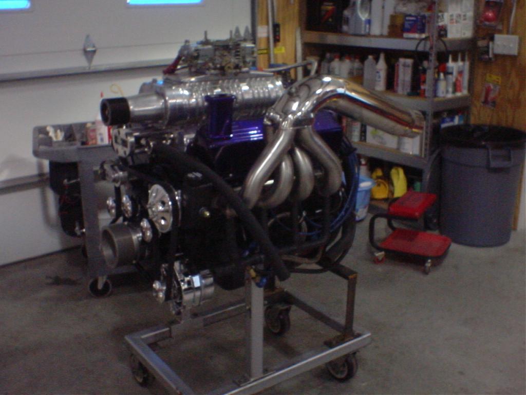

Some pics of the engine on the stand after the serp. kit was installed.
Attached Thumbnails Spring Upgrades Finished!!-hoist.jpg   Spring Upgrades Finished!!-serp-front.jpg   Spring Upgrades Finished!!-serp-headers-side.jpg

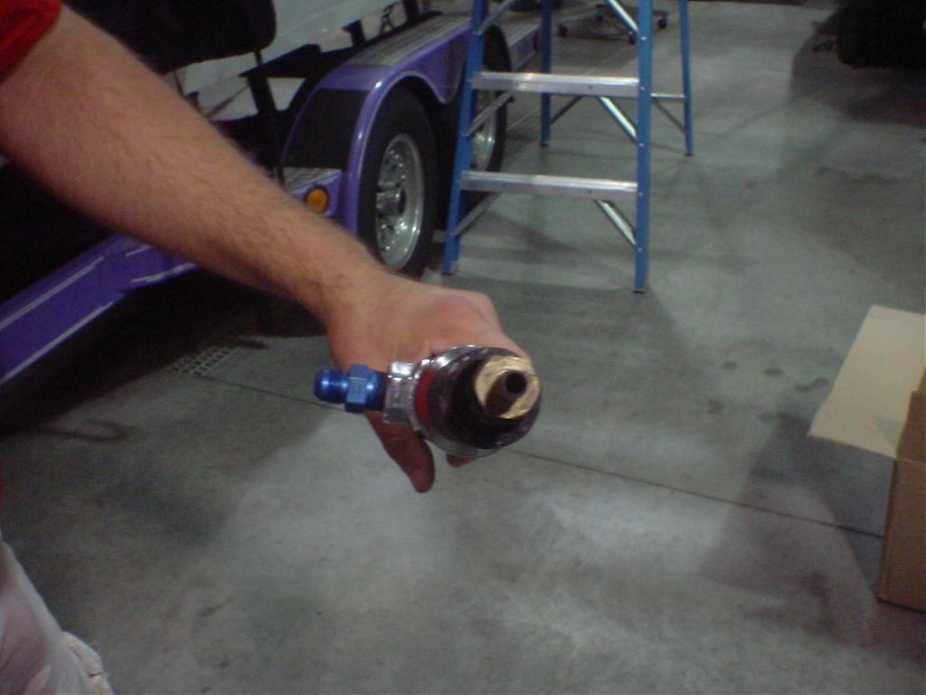

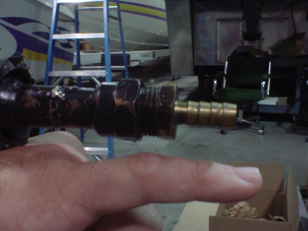

I posted these the night we found it, but this is why the oil cooler had to be re-worked....this is not a joke!
Attached Thumbnails Spring Upgrades Finished!!-dsc00094.jpg   Spring Upgrades Finished!!-dsc00095.jpg   Spring Upgrades Finished!!-dsc00096.jpg
