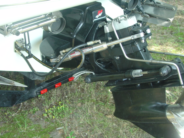

I would try a 2" spacer with the imco shortyies and IF it feels like its dragging and gains no speed but your slip drops back to what it was before the boxes its time for the boxes to come off and become somebody elses problem. I too have rerigged my boat (a 2000 272 baja w/BIG power) with a stellings box. It ran 89.5-89.8 any day of the week before the box and would run 92.5-92.8 running light. After installing the box it would barely break 86-87 mph,porpoised badly,would no longer carry the bow etc. I put a 1" spacer on it which helped return the handling and ride BUT slowed me down even further to 84 and change. Not every hull works well with exstension boxes,yours might also be one of them,I'm sure you don't want to hear this though. Make sure and try a assortment of props before giving up however,maybe a 5 blade hydromotive would bring your slip back down and speed up,its obvious your prop slip is way up,either prop is just too high or somehow the water is disturbed 12" back because of something about your hull design. The prop experts felt my padded bottom on my boat was the reason why the box didn't work for me,Smitty
Attached Thumbnails Engine Upgrades plus extention boxes and shorties - need help-boyne-079.jpg
