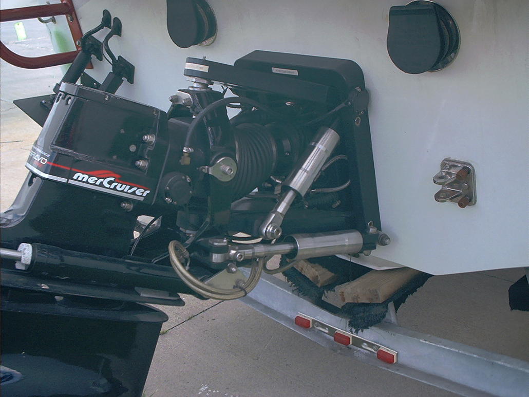

74 mph out of the Baja 236 Wow! We never have a chance to put that kind of HP in one at the factory back in the day, but I knew that was a good running hull that could handle more HP. The 236 was my first whole boat design project at Baja, and was the very first model to have the molded steps in the dash to the foredeck. I had the Baja 260 at the time and loved the boat, but hated how hard it was to get on the deck. So that is how steps became involved on all the newer model Baja's.
Back to the subject. Your explanation on the x-dimension is right-on target, but here is something to really get everyone confused. We did some testing on a Baja 25ol with a very special transom assembly that was called "X-Factor" and operated much like a stern jack for a outboard engine. There were patent numbers all over this thing, and I think the main goal was just to sell the rights to Brunswick? Never heard anything on it after that.
XT
