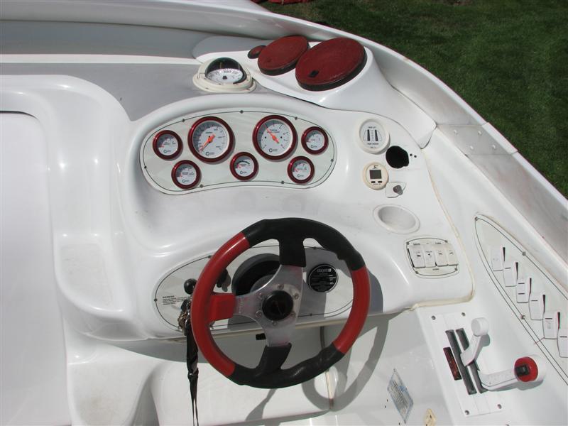

There were always (2) Hull molds at Baja for the 272's and later used for the 275 model.
There were also (2) early Deck molds for the 272, and later we built a 3rd deck mold that was built to accept the Plex. Windscreen option only!
Yes, there were times when production grabbed the wrong deck mold....
XT
Attached Thumbnails Are all Baja 272 the same?-272_windscreen.jpg   Are all Baja 272 the same?-272_ws.jpg

Who makes those speaker pods??
