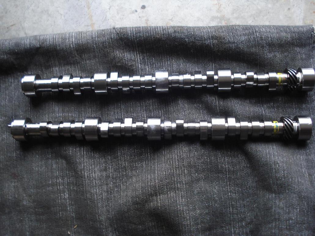

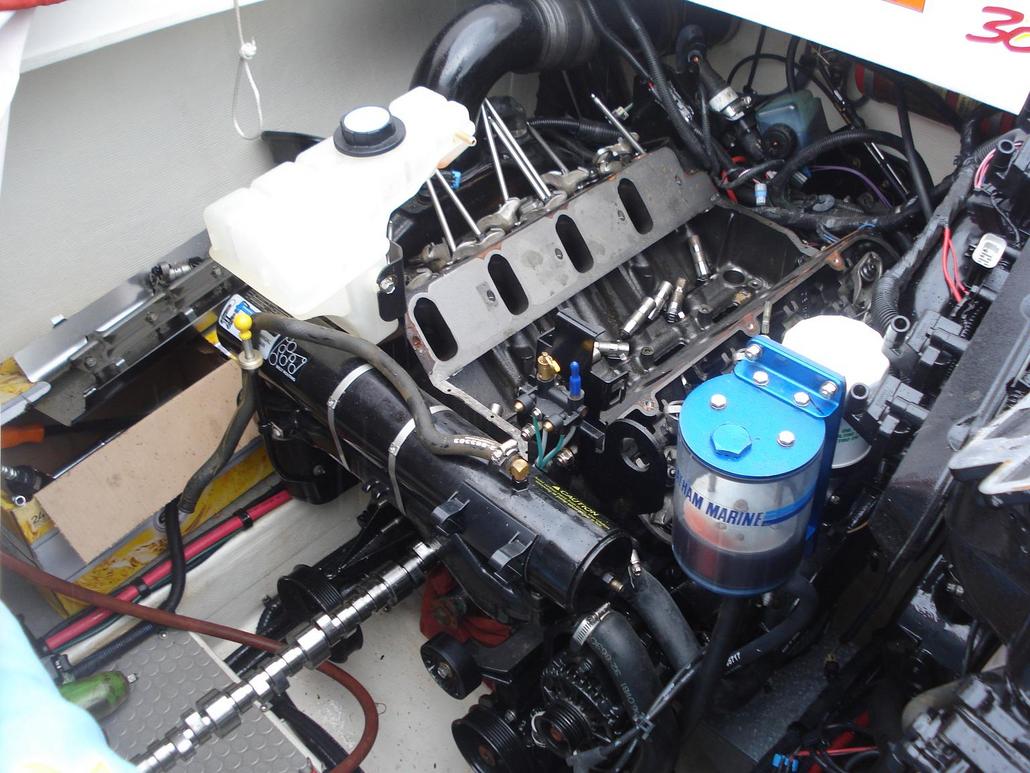

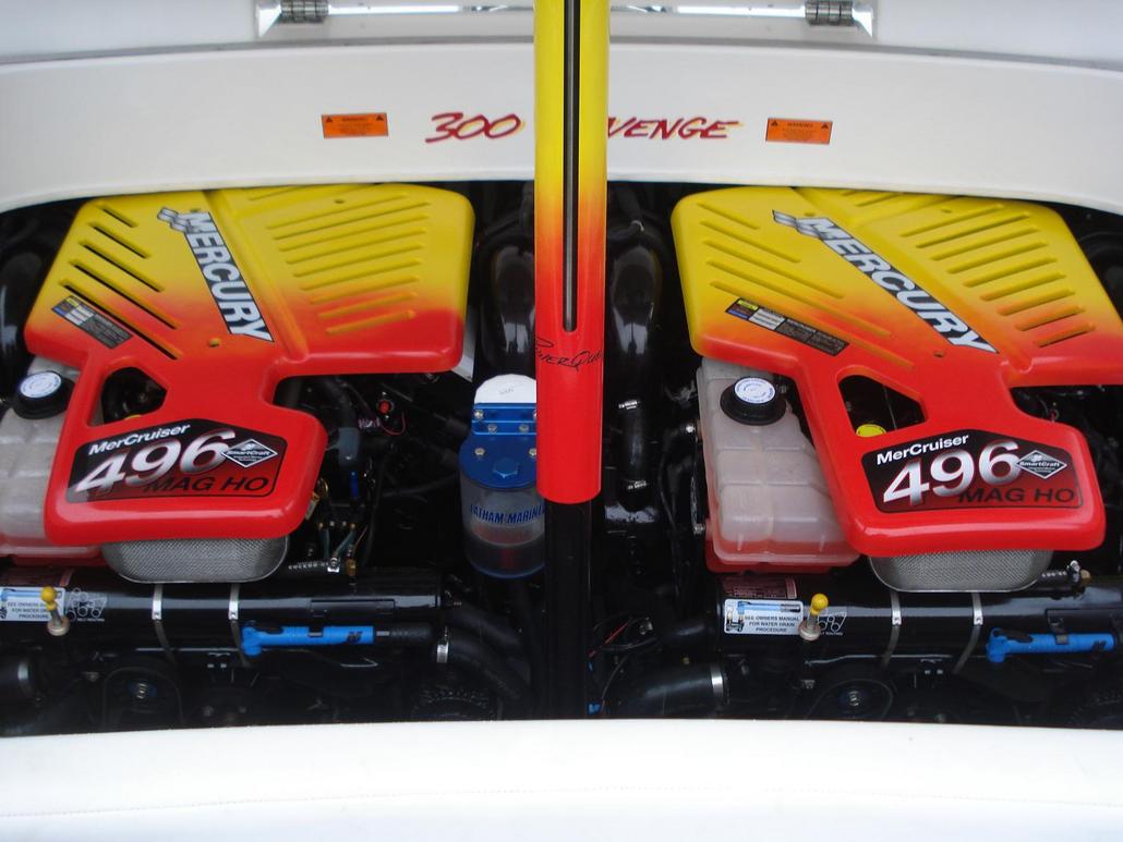

This is what you need to do,,,Cam,,Drill idle bleed hole on throttle body from 1/8 to 1/4,,,ecu reprogram..prop...New engine cover decals...
I have done it on my last 2 boats and worth it!!
