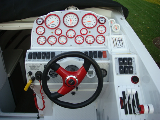

I`d like to add two more 2 1/16 gauges and the only placement i see available is above the trim indicators but they`d have to be on an angle to see em. any ideas?

You could get a sheet of aluminum and make a new panel and move the gages around so as to have more room. I did that on my 24 Outlaw. You could cover it with that cool carbon fiber look vinyl or whatever you wanted to to change the look.
Or you could buy gage pods like in the picture below. I got them from Livorsi.
And for those that are trying to figure it out, the gages in the upper corners are real time air/fuel ratio gages

Thats what I`m putting in two air/fuel gauges.
I can`t find the pods on their site, I`ll give em a buzz .. thanx

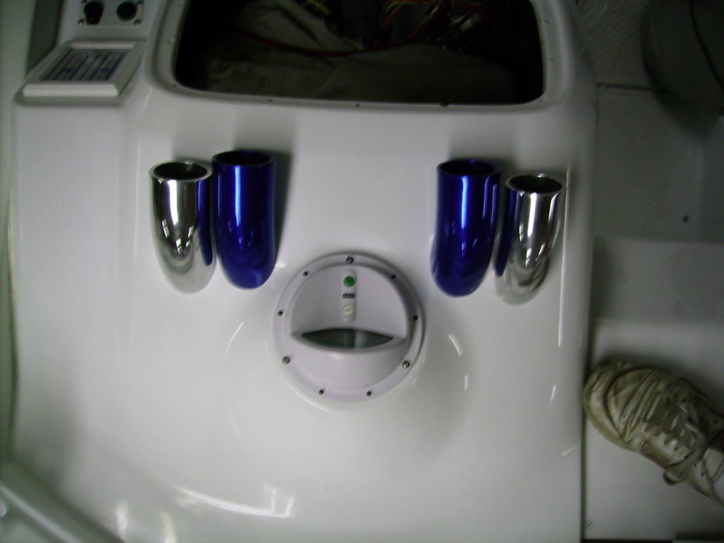

Yup go with the pods like Doc Holiday did in his 36. I can find a photo somewhere, but I remember them being Dana's.

I did Doc's install, but my photos are not the greatest.

Perfect exactly what I was looking for .. thanx

They worked pretty well, only gripe is the mounting inside the tube. The mounting tabs are too far inside to secure the gauges.
I had to wrap them in electrical tape, they are tight but only time will tell if that works.

They will be fine. I wrapped mine as well and have gone 3 seasons with no movement.
Looks good, nice install !!
