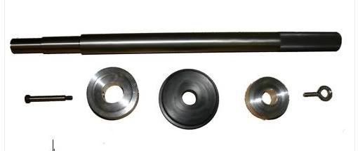

Was thinking of ordering one of those kits on Ebay that has six tools - Alignment tool, bellow expanders, seal tools, etc.
$120, all U.S. made.... anybody have any experience with them? http://www.ebay.com/itm/ALIGNMENT-GI...207be2&vxp=mtr

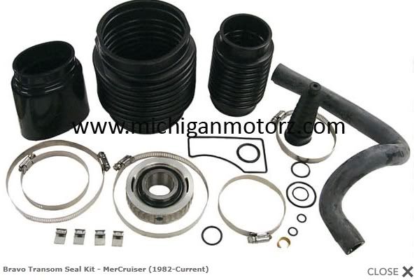

Anyway, ordered this kit today: MerCruiser Bravo Transom Seal Kit 30-803100T1 from a buddy who can get OEM Merc. parts at good prices ($175 CAD) for the kit. Not sure if the bearing will be the greaseable, or Permalube type yet... we'll see.

Parts guy says the seal just forward of the gimbal bearing is not required if the new bearing is the Permalube type. I believe I read somewhere that this seal is only to keep grease at/near the bearing, so maybe this is correct, and not required?
