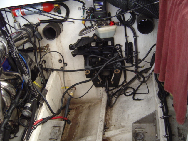

Hi guys,
I have a 2000 Baja 272 where I am about to swap out the 7.4 MPI for a 502 Mag MPI. The boat is in really good condition, except I feel the engine compartment needs to be touched up. The new engine is going to look new, and the paint in the engine compartment is flaking and discolored from oil and rust.
Question is, how do I make this right to keep it nice for many years to come? What kind of paint do I use?

I used Interlux Bilgekote on mine and it's been about 5 years since I have painted it and it still looks pretty good. Here are some before and after pictures.
Attached Thumbnails Engine compartment paint-dsc09780.jpg   Engine compartment paint-472-7219_img.jpg   Engine compartment paint-472-7250_img-small-.jpg

I just got industrial imron high gloss. It's hardens like a rock. Primer paint and activator are $$$$

I just used imron and brushed it on dries like a rock. Just really need to clean and sand and scrub. Let me know if you need any help. Also you would never know I used a brush. Next time I might do a little more work and smooth it all though.

I used bilgekote also, but I also replaced my boxes on the sides because I knew they were wet. I have done other boats also. Like it was said above: you need to clean it really good and sand and clean, then I just applied 2 coats of bilgekote.
Attached Thumbnails Engine compartment paint-100_0389_small.jpg   Engine compartment paint-100_0669_small.jpg   Engine compartment paint-100_0792_small.jpg
