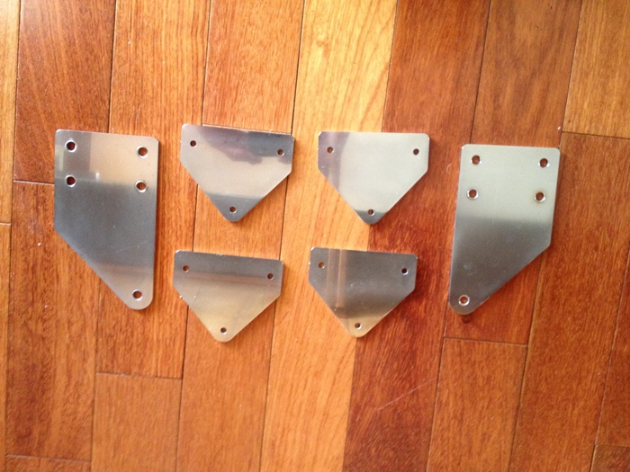

Here are the hinge plates and new brackets for the hatch actuators (going to two to hold the sunpad down, another story).
I have drawings for all these parts if anyone would like copies. I've also generated drawings for many of the dash and switch panels when I installed a chartplotter a few years ago.
Hopefully it will all start to go back together pretty soon.
Dan

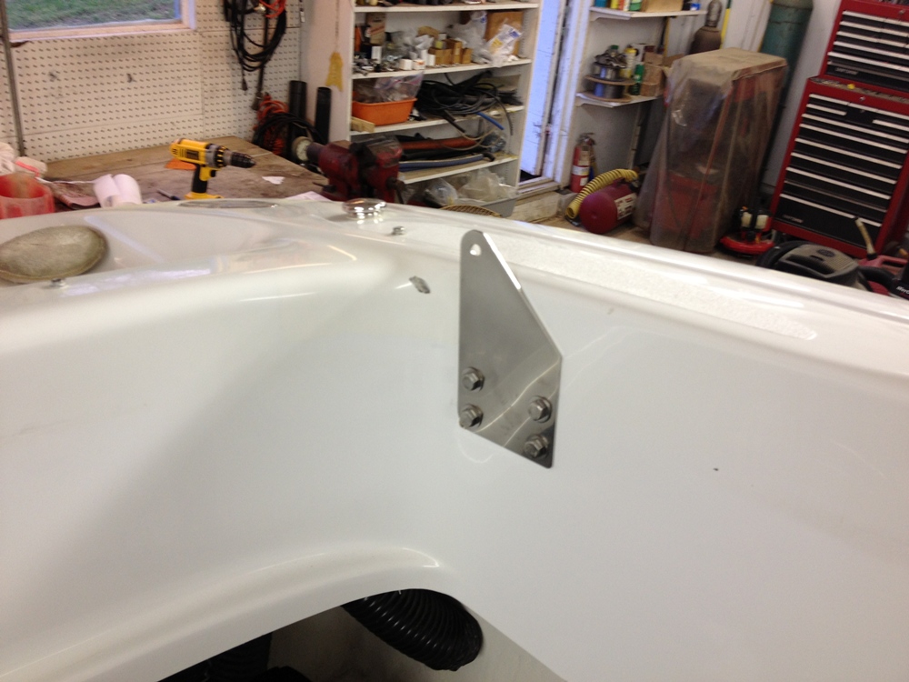

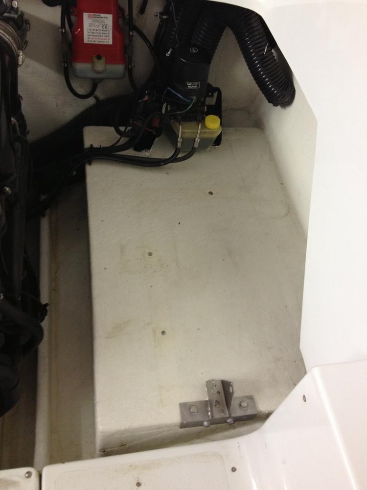

Well I made some good progress last night. I had been saving all my part installations that required caulk until I had all that I anticipated ready. So last night, the tube of 4200 was popped open and the work began. These included bedding new drink holders (I can do bling as much as that may amaze some people), bildge vent hose spigot installation in the air intake box (the hoses are just crammed in rough openings in the bottom of the box from the factory), removing all screws, sealing and bedding the trim pump. Unsealed screws are the bane of Baja, Hook'em being the worst victim I know of. A little dab of sealant from the factory and these boats would have lasted forever. And finally the installation of the lower hatch actuator brackets and new hinge plates. It is very satisfying when you can actually start assemblying things isn't it? Hopefully I will have the new firewall by this weekend. I still have a lot of work to do rewiring the battery selector, the hatch actuators (this will require a relay pack) and installing a new automatic charging relay (ACR). It is a good thing I beleive that making it better is almost as much fun as riding in the thing!
Dan

so when beside the boat, your going to see the hatch hinges sticking out above the fiberglass?

some one is going to loose some skin on that hinge sticking up like that
Prob not unless your looking for it. But when your buzzed up and step across the pad in the wrong spot you sure will feel it. Had a buddy do this exact same thing to clear a turbo setup on a Sunsation. Not the greatest idea he had...
