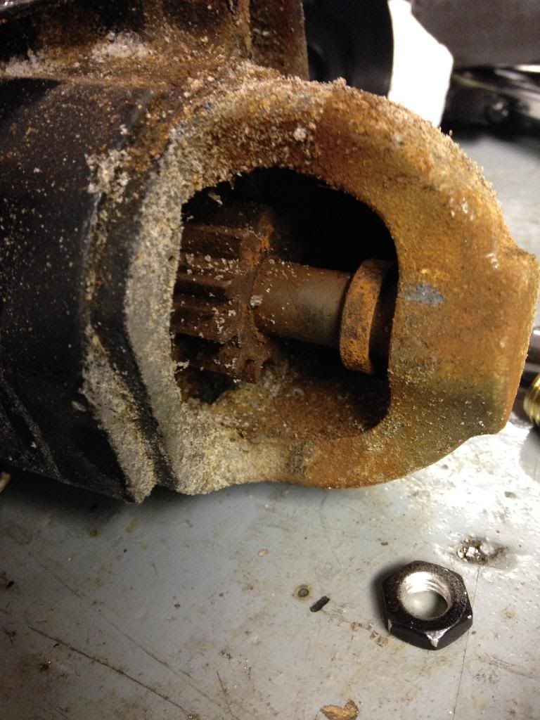

well, I had my small friend who was able to roll off the front of the engine and bend along the stringers to get to the starter without taking anything apart other than the raw water hose.
this is what I found

Wow!!!! Gear is rusted right to the shaft / bendix. Did you figure out where the water came from or how it got in there so much? Drain hole +1, but I would still try and figure out why.

the water came in during 1 trip coming back in some rough water every 15 or so min the nose would just catch the top of the wave and a slug of water would come over the dash onto the floor then drain into the bilge as its designed i would pump it out but with the size of the waves it would slosh around and touch the flywheel. im guessing with the heat on the starter while running that wouldnt take long. I experinced the problems when i got home and was flushing the engines at the end of the trip so im confident it happened then. Im wondering too if the shield is missing from the bottoms of the bellhousing
That hole is no drain its on the side of the starter and will allow me to spray some oil into the end of the starter to keep it lubricated
