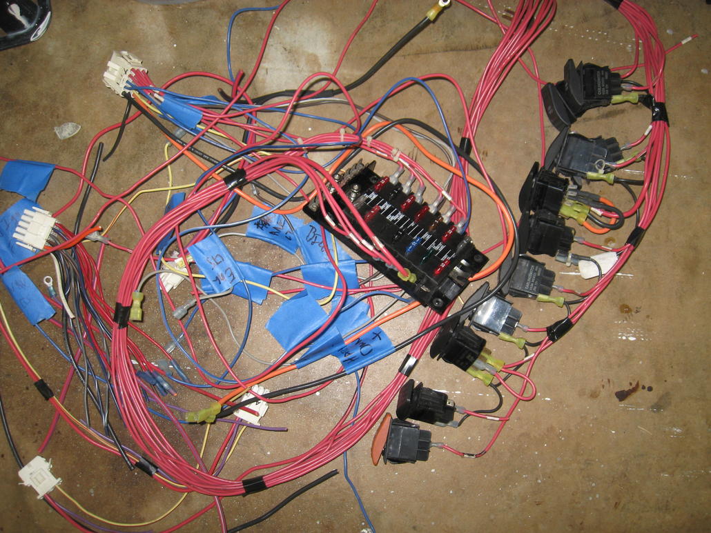

Our 252 is a 2001 vintage and did not use the newer Deutsch connectors that are really nice, waterproof connectors that don't cost an arm and a leg. So long story short we converted to the new connectors. Try www.wirecare.com for great products and service. Actually this was a larger project to improve the dash so we ended up doing a lot of wiring. You probably will also. The boat will be 10 lbs lighter when you finish.
Dan
[ATTACH=CONFIG]526404[/ATTACH]
[ATTACH=CONFIG]526405[/ATTACH]
[ATTACH=CONFIG]526406[/ATTACH]
Attached Thumbnails Upgrading switch panel-img_0611.jpg   Upgrading switch panel-img_0636.jpg   Upgrading switch panel-img00522-20110228-1726.jpg

BajaDan - How are the new switches lighted? From what I understand they should be red when the Nav/Anchor light switch is turned on. Then change to white when each individual switch is activated? Is that the case or is there some similar version of that scheme?
jetskidrewski is offline
Old 08-12-2014 | 01:19 PM
Joined: Jun 2010
Posts: 392
From: Birmingham, AL
Yes, they are lighted. Been a while since I ran after dark so I will have to verify the red with nav light function. White when activated for sure.
