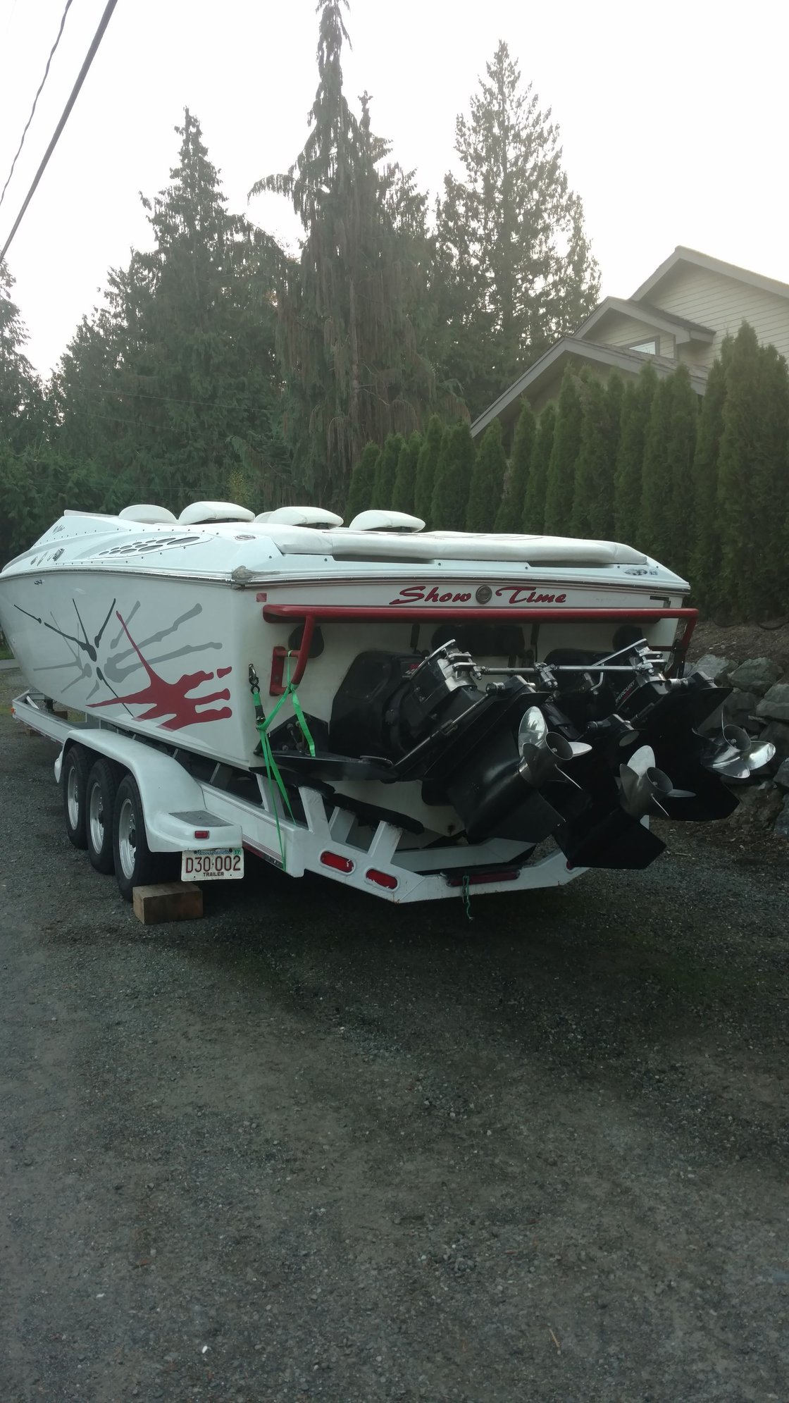

I came home the other day and this was parked in front of my house. No, wife wasn't trying to surprise me. 500EFI's, Bravo's, 26 P props, "Show Time", Massachusetts plates on trailer.
New owner wants it to go 100MPH
Any history on this boat?
What would it take to get it to 100MPH?

I Nice 650 w a good trailer and you might hit a Hundie.

Id say: Ditch the trips, go full staggered with 850-900 hp a side. Clean up the bottom of the hull depending if there is a hook

Center leg needs to come waaaay up, she needs to go on a diet if she as the full cabin and you need a hell of a lot more power. Great rough water boats, love the 40 but I'd rather a twin set up as they run just as good if not better.
