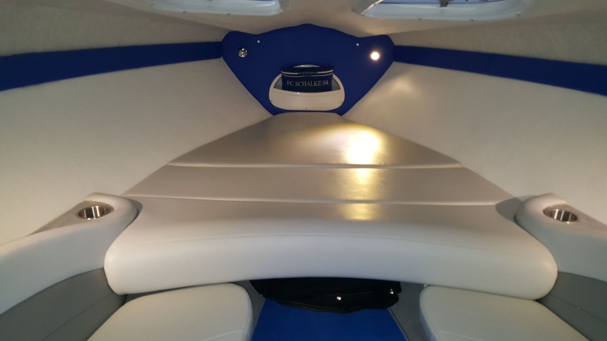

I placed 2 subs 10 inch under the bed in new panel that was fixed with screws.Now add a bit more colour.
Also mount 7 7 JL in standart holes that must be open a bit and will update to 8.8 JL in rear seatbank next time..Michael
