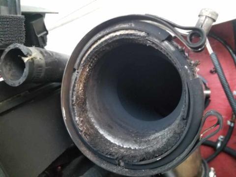

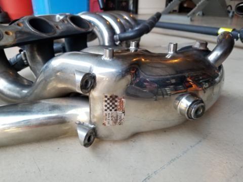

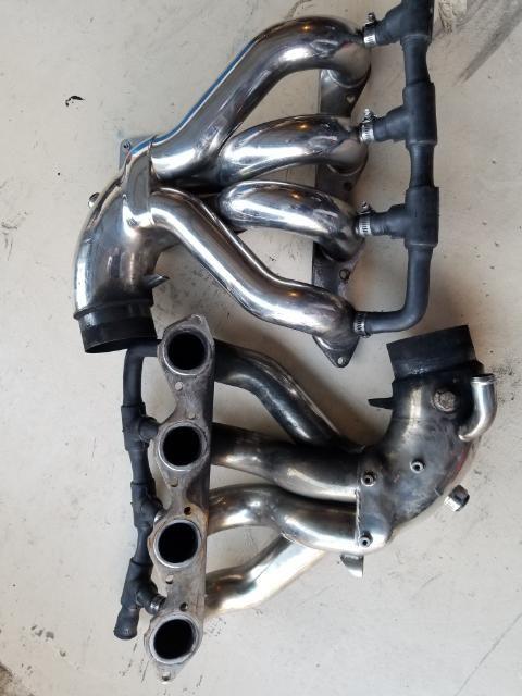

K. Headers pulled. Pics taken, how do I post?

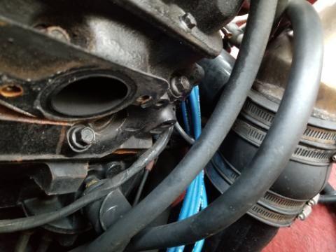

Got it! Also took a pic of the fuel regulator set up, If I am going with the MPI, I will need help diagnosing why it is running so rich.

Getting Late(dark) here I was going to pull the drive today, but it will have to wait till next weekend. It's dark when I leave for work and dark when I get home. Might get ambitious and get the engine out and on the stand too. So I capped the collector end water outlet with my hand and blew into the rubber water inlet. Starboard side held, port side was definitely not holding. I know its not a real test, but it doesn't seem good. Wondering how the "send it in and have it tested" thing works, if one side is for sure not holding pressure, should i just order a new set and save the 150? Or do they apply the 150 toward a new set? If there is any chance they could be saved it would sure help with the repair cost of this engine job.

Originally Posted by tmmii
If they are next to each other you could have a head gasket blown between cylinders.
Number 7 and 8( back cylinders one on each bank). If both head gaskets are blown, they are blown into water jackets, as there is no external signs. I would think there would be some water in the oil. We will find out soon. Gosh I hope the block is ok...
Shotgunn is offline
Old 11-24-2019 | 05:43 PM
  #40
Joined: Aug 2014
Posts: 1,031
Likes: 225
From: Ohio
My misunderstand. I thought it was the rear two on one side. 7 & 8 usually run leaner than the rest. A few engine builders are adding a second fuel feed line to
the rear of the fuel rail.
That part of the block should be fine unless it was seeing a ton of blower heat. They will probably deck it though to be sure everything is straight.
tmmii is offline
