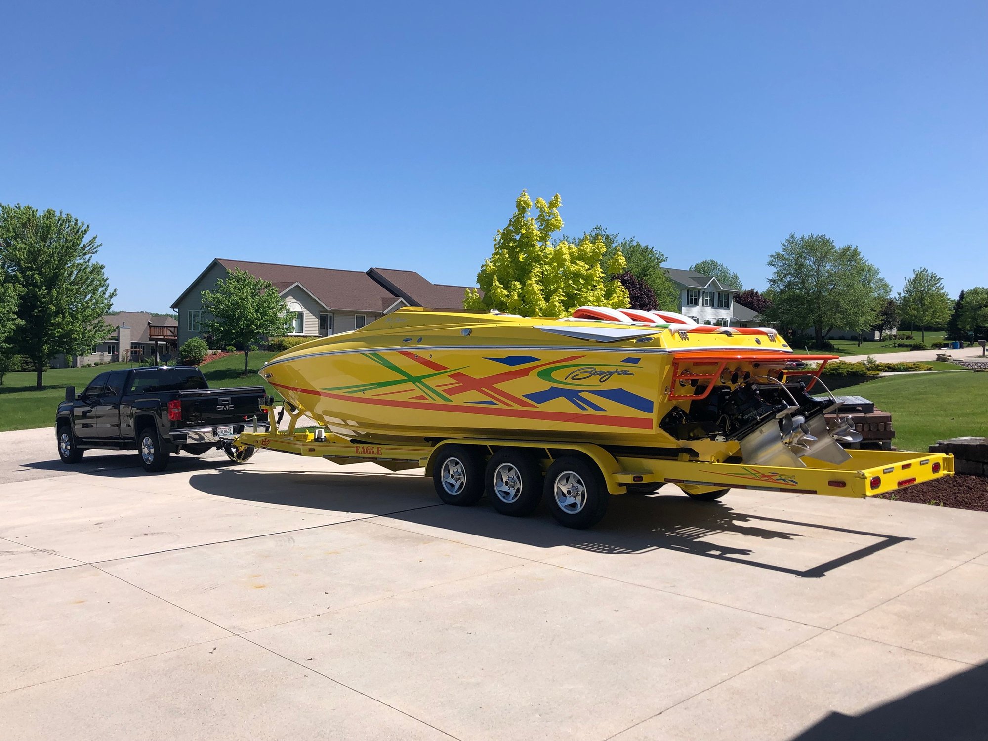

30outlaw 03-04-2020 09:43 AM
https://cimg7.ibsrv.net/gimg/www.off...fc0b35e035.jpgand ready to roll... not giving a lot of oh **** room it was the weekend before the 2019 Lake Winnebago Four Horseman poker run was able to get it out to bleed the lines etc. not knowing what to expect never having engines out before wasn't going to go into the poker run without a test run... was kind of surprised no issues! started and ran perfect had a nice bark without the mufflers ITS system bled it's self... it was a great weekend on the water!
