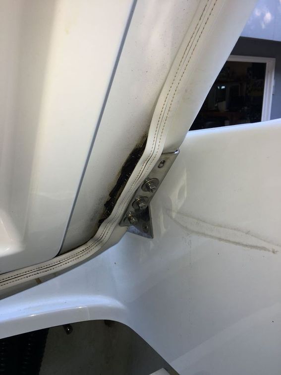

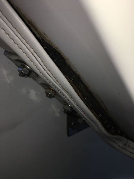

Bought a very nice 2000 252 Islander a few weeks ago, the boat has been kept in extraordinary condition. The only thing that needs attention is the sunpad/engine hatch where attached to the brackets; there is some wood rot that I am going to fix. Does anyone have any idea how this area is constructed? It almost appears that there is/was a layer of wood on the underside of the perimeter of the hatch used to staple the vinyl to. The underside of the hatch is fiberglass. On the port side, one bolt has sheared off, the others seem to spin freely when I attempt to turn the nuts...indicating the heads of the fasteners are not secure, not surprising since this wood seems to be nearly totally rotted away.
My plan at this point is to use an oscillating tool with a carbide blade to cut the bolts off, then pull the entire hatch off and evaluate for repair. If anyone has any understanding of how this is all constructed, I'd really appreciate your comments.

To the top. I am trying to figure out how much wood is in the hatch...how big of a project this could turn into.
Has anyone had a hatch/engine cover off and apart? I assume there is the vinyl covering, foam, then either fiberglass or wood then fiberglass. The inside of the hatch is obviously fiberglass.

I had to repair the hatch on my 33 in the hinge area, you’ll need to get it down to the base hatch( all upholstery and foam removed) then, from the top side ( upholstery side) you’ll have to cut through the glass with a cutting wheel and remove the wood ( I don’t know what the framing structure of a 252 is, but a 33 just had blocked in areas) as needed.
They use threaded inserts with barbs on them that you drive into the plywood, I cut the wood as needed, resined it into place, clamped, then from the existing holes in the opening of the bottom of the hatch, I drilled holes for the inserts, installed the inserts, then feathered back the areas around the cut and glassed it back up...I think I used at least 4 layers to match the thickness but can’t be sure... this was 15 years ago when I did this
