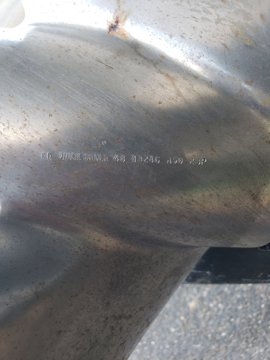

I'm sorry, I lied . It is a quicksilver 23p
https://cimg9.ibsrv.net/gimg/www.off...7897f4c6ba.jpg
23 p i assume p= plus?
SB 09-16-2021 07:01 AM
That # is a 23pitch Mirage + . P is for pitch.
