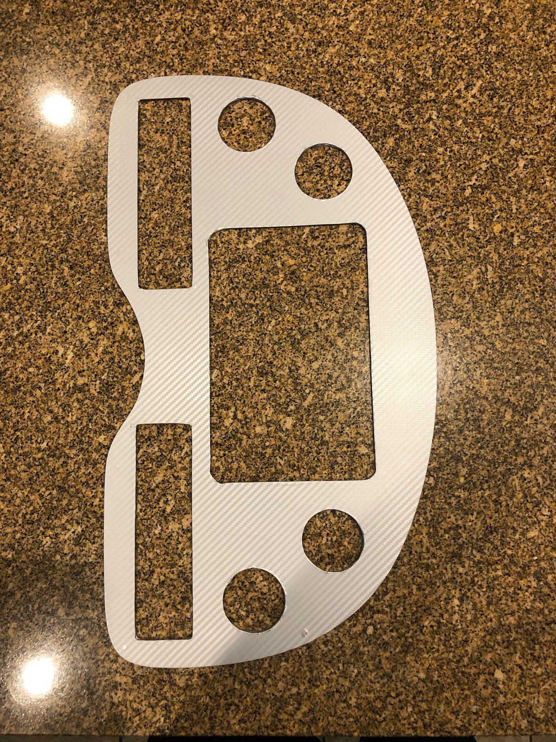

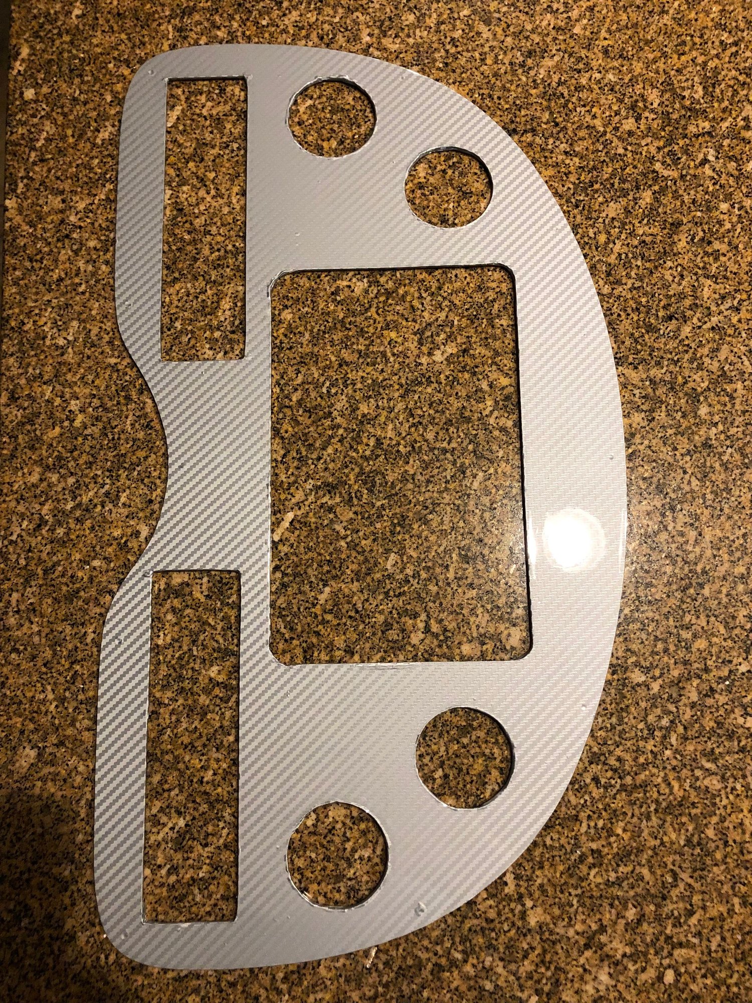

Originally Posted by Leick238
Looking to replace my panel and gauges in my boat. I know where to get the gauges but can’t find any place that has panels. Is there a place I can lookup panels? Any info would be grateful!
I made a template of my original and fabricated out of 1/8” aluminum sheet stock using a combination of a cutoff wheel, a Dremel with a small cutoff wheel and various bits, a hole saw for the gauge openings, and my bench mounted belt/disc combo sanding machine. Once that was done, I wrapped it in silver carbon fiber vinyl wrap and put eight coats of 2K clear coat on it to give it the factory depth of shine you’d see in a OEM carbon fiber panel.
