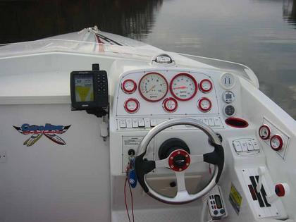

If you use a remote access microphone vhf you have about the same volume as you do with your handheld. You will have a hard time finding a vhf that you can hear underway. I have mine mounted right below the shifters, and I can just barely hear it when up on plane.

If you look in the picture right below the GPS, I have a removable antenna. When you are not using it just twists off. It is a 3 ft. antenna and it works great.
I wish someone would come up with an antenna like a car radio antenna where you could make it electric.

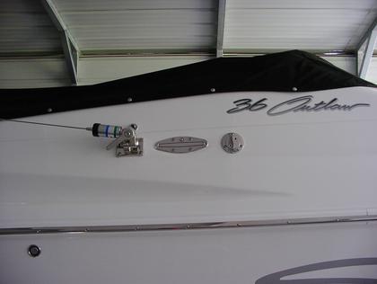

I mounted an ICOM in the 272 we had like you are talking about with the remote control mic. Put the unit flush mount to the bulk head just left as you entered the cuddy and the mic at the helm. It worked pretty well.
The problem is with any performance boat with engine and wind noise you will not be able to hear much.
This is why on the 36 I had the VHF interfaced with my headset communication system.
Here are a few pictures.
By the way, I keep a backup handheld unit in the boat also for safety. It also come in handy to carry when you are at the docks or a local resturant you can communicate with friends as you see them on the water.

Old 02-24-2004 | 03:42 PM
Dock Holiday's Avatar
Charter Member #34
Posts: 7,151
Mounted Unit to right for easy access.
