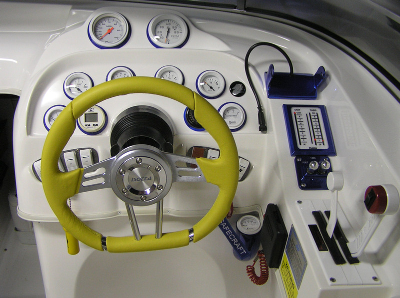

How tight was it getting your cables into the indicator ?
Is your indicator bottom fed ?
I am just finishing up my tab installation. Will post pictures soon. Pulled old insta-trims, plugged, resined, gel-coated old holes. Painted transom black and installed red Livorsi ( Dana/Eddie ) 24" tabs. Indicator installed in dash, waiting for cables to connect.

I have posted these pics before, but its no problem to post again. My cables come up under the gunnels, then swing around the front of the indicators and attach to the indicators from the front. Now, Livorsi makes those neat pop up indicators. They may fit as well as the thin line I used.

Sorry, I dont remember. Before I ordered them, I just ran a tape measure along the expected routing, then ordered the next longer cable. Just make sure you get good quality cables that have alot of flex. The bend up front is tight for cheaper cables.
