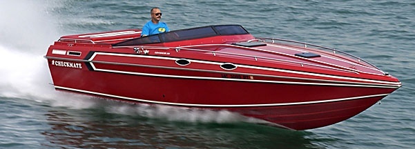

Do any of you have scoops on your Checkmates? I'm thinking about putting them on my 280 Convincor. It has twin 454 mags with Whipples. I had to raise the engine hatch 3 1/2" to allow for the blowers. I want to drop it back down in place and give the motors more air. Any pictures?

Old 02-15-2003 | 12:53 AM
Quiet Storm's Avatar
Joined: Apr 2002
Posts: 1,683
From: Lake Michigan
Okay I think I may have this right now.
Quiet Storm is offline
