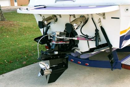

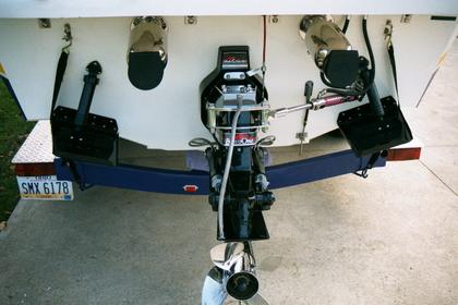

Do you get out to Berlin Lake by Franks much? I do most of my boating out there. I have had Frank to work on my Checkmate. What graphics to you have on your 253? Here is a photo of the tabs Frank put on my last boat.
