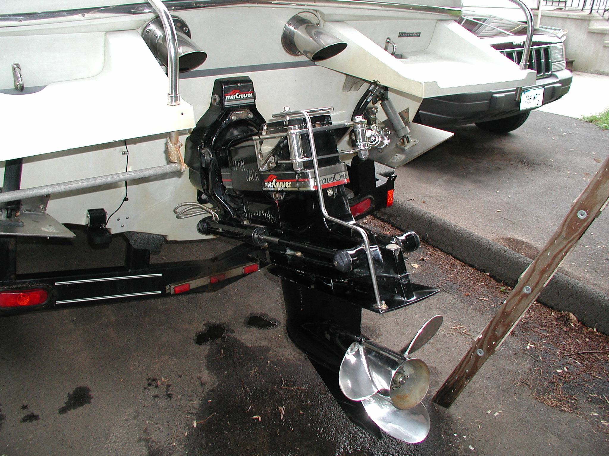

Had 89 GTX Convinsor with land and sea sternjack, did not chine walk at all but there tough on gimbal bearings.

Thanks for the comments. Mark why do you say it will chine walk ? ZZZZZZ's the land and sea is totaly different, but how did it run with it ?

74 GPS, I believe it helped and it's pretty cheap. you might find one used. also helped with the holeshot.
