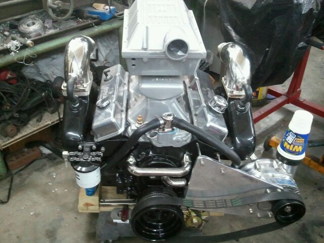

We opt to do a forged 355, stuff it with boost
John jr
