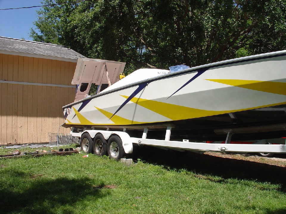

hull pics
Attached Thumbnails 35 mistress is getting close pics of progress-cig_cockpit_resized.jpg   35 mistress is getting close pics of progress-right-side_resized.jpg   35 mistress is getting close pics of progress-cig_rear_resized.jpg
ratman is offline

more hull pics. otice the alum fairing was removed and the previous owner flassed up the new fairing like the later model boats he did a sweet job.
Attached Thumbnails 35 mistress is getting close pics of progress-cig_front_resized.jpg   35 mistress is getting close pics of progress-cig_side_resized.jpg
ratman is offline
