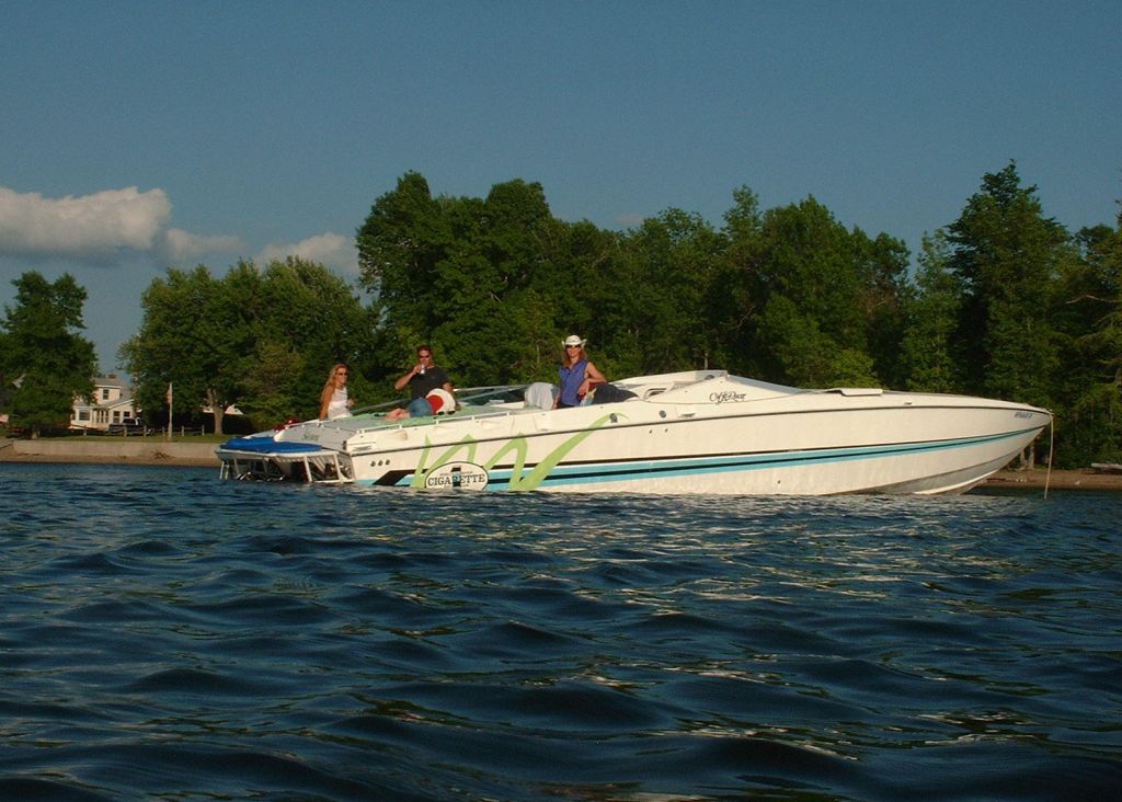

I had a 94 pictured below
#9800 dry
Beam 8'
Mybet is low 70's with that power
Problems... have a survey done Leakdown on engines and have fun once everytihng flies.
Attached Thumbnails Is there a Cig. in the future????????????-1024ramp.jpg   Is there a Cig. in the future????????????-cafe.jpg
