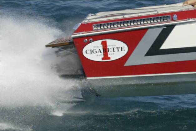

Here is my 85 38 Cig with Konrads taking a beating on Lake Michigan. Best thing I ever did!!
Mark
