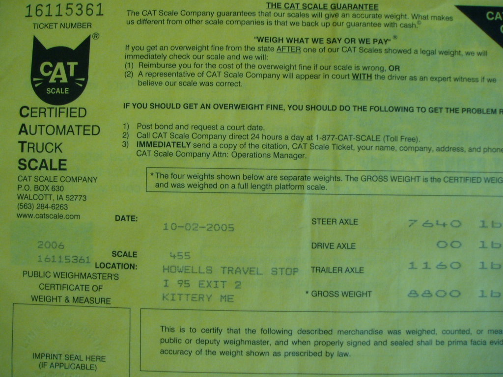

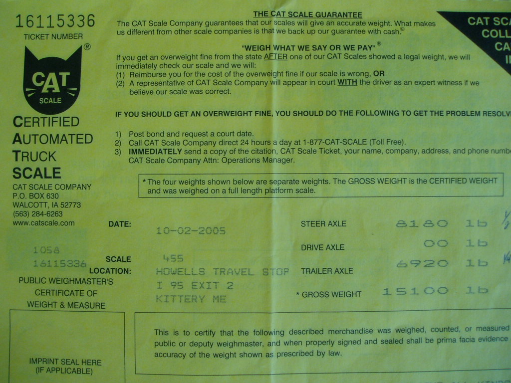

Funny you should ask this. I just came across the print outs of when I had my boat weight last Fall at a certified scales.
1st pic is Excursion only = 7,640 Lbs
2nd pic is Excursion + Trailer = 8,800 Lbs
3rd pic is car/trailer/Cig = 15,100 Lbs
Tandem axle Loadmast trailer is just under 1,200 Lbs.
Cig is 6,300 Lbs on this day. Very light (less than 1/4 tank) fuel and cooler is empty. So you could be adding another 90+ gallons (540 Lbs) and 4 cases of your favorite beverage, food and ice on top of this and I'm over 7,000 Lbs without even stepping on the boat.
The important point to note here is mine is converted to a single BBC, so take that conservative 6,300 Lbs and add another engine & drive and your probably very safe guessing at least 8,000 Lbs for the boat alone.
For insurance reasons, you really should not be towing one of these with anything less than a 3/4 ton.
