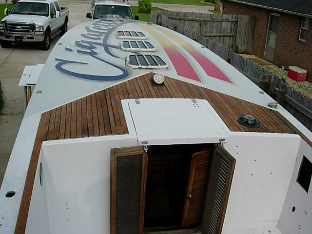

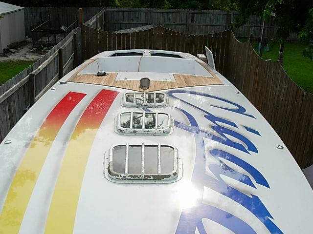

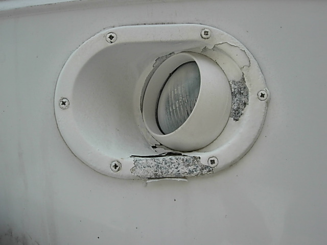

Removed old wind shield to redo the teak,really do not like the looks of the old style and it was in bad shape.Any ideas on new style or materials to use?Also need to replace docking lights,any idea where to get replacements?

It's coming along VERY well Justice. Here's a link to a replacement http://www.shopping.com/xPO-Sierra-S...-Docking-Light but I guess it depends on the size of the existing hole. I would get with Sierra to find out what size holes these new ones require and they may fit. I also noticed all your transom work and it's awesome too. Glad to see you're continuing to make progress and let me know if I can help.

If it's salvagable, I say "Keep the Teak!" The teak on the dash is over 1/4" thick and takes well to sanding & re-finishing. I used a belt sander to sand away the weathered material then use a random-orbital to finish sand. The belt sander will take the rubber strips down even with the wood, too. Caution - keep the belt sander moving so not to "dig" a hole. Finish with multiple coats of Watco teak oil (available at Home Depot). The finish will easily last me an entire season or more here in the midwest.
For the docking lights, it looks like they're aluminum housings. I'd suggest media blasting and powdercoating. I think you'll have a hard time finding a direct replacement to fill the same size hole.
