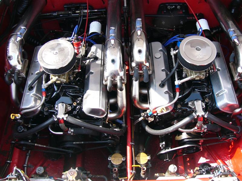

Engine assembly:
-509 CI
-SRP pistons
-Edelbrock RPM intake
-Comp Cams roller valve train
587 intake 601 exhaust 226/234 duration
-GM Retangular Port heads, some bowl
blending, Manley Severe Duty Valves
- 830 CFM Holley
-CMI Exhaust with Stellings' Dry Pipes
Attached Thumbnails 38 Flatdeck Redo Complete-p1010076-medium-.jpg   38 Flatdeck Redo Complete-p1010085-medium-.jpg   38 Flatdeck Redo Complete-p1010077-medium-.jpg
