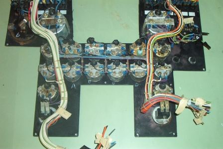

installing all new gauges. im also getting rid of (2) hour meter gauges in place of tach/hour meter combination gauges. if i also remove the fuel pressure gauges i will have enough room to use monster series but they will need to be moved around somewhat.
looking at all the wiring, how the heck do i go about this. most of the wires are only long enough to reach the gauges where they are now. if i cut all the wire ties i will really have a mess.
oh, and im color blind
i wouldnt mind paying someone to do this for me but i dont know where to look. electrician?
birddog how did you go about doing yours?

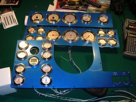

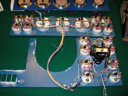

Sure would have been alot easier if CRT had the harness designed with plug type connector. If you cut the nylon straps holding the harness together it will give you a little more slack.

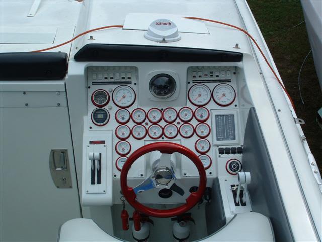

pm me and give me your phone number.......I really enjoy duing stuff like that.........I have done all the work on my mag..........
i have even put warning lights in each corner for oil temp and oil pressure...............

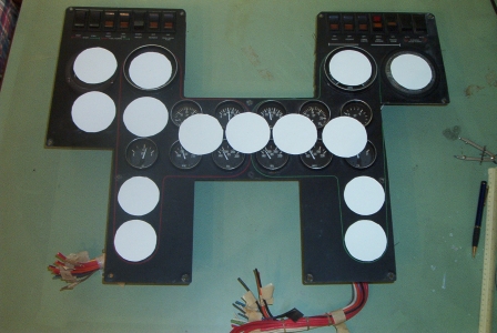

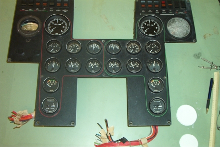

game plan
