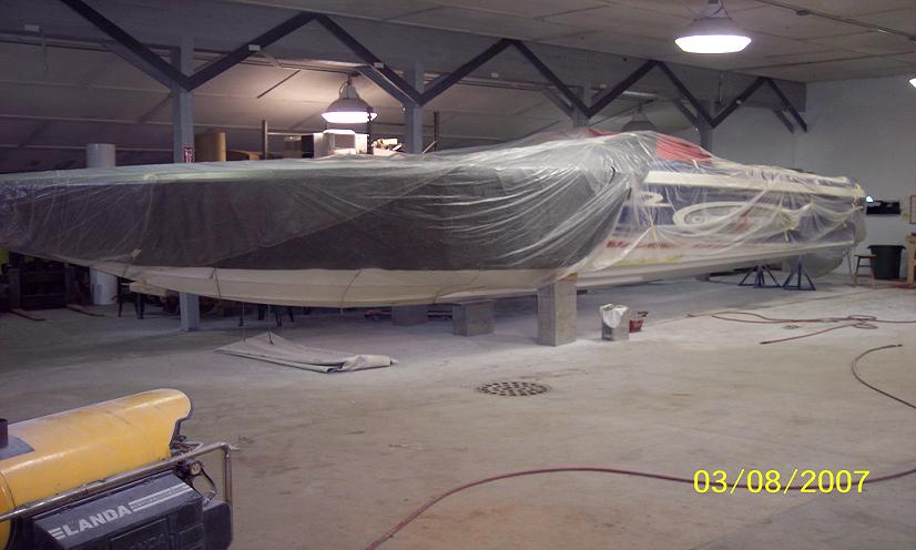

We finished doing a complete resto on this boat last spring. And we had a trouble free summer. And now its in pieces again. We regeled the bottom and blueprinted it, sent the motors out to be checked and new MSD, pulled the front two fuel tanks out, redone stringers, rebuild engine hatch and floor, lightened up cabin liner and reglassed it in, new dash and thro/shifters on the way. And Mike at fineline has the interior. Here some pics

We will have it ready for summer. Best we got out of it last year was 78mph on gps. With all the work done we hope to be running in the mid 80s. Yes we have done the dash and int. but we are going with blue carbin fiber panels and monster gauges. The bottom I long boarded then we regeled and now long board one more time and finish sand. Also sharpened all the strakes up. So far we have lightened the boat up by 1250lbs.

thats runnin pretty good....1250lbs..daayum..tht oughta help alot...wheres most of the weight ur takin out comin from? with the triple set-up, we are def plannin to make some sort of lighter hatch like you did to get some weight taken from the azz end. looks like yal are havin lot better luck then we are mid 80s is haulin fer tht big suckr....hope to see yal in a poker run sometime if we ever get runnin
