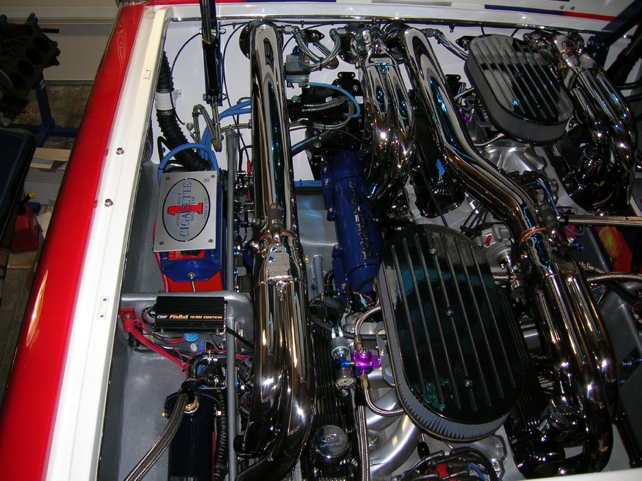

locations I changed from stock
Moved batteries back
closed cooling on stringers, not engines
oil coolers moved to middle stringer, down low
shortened drive shaft .500" (to fit bigger engine)
added bilge pump filters on port side
The starboard side closed cooling holds about 1/2 gallon less due to shorter hose routing. But this is the side riding low.
I adjust trim to keep RPMs equal at same throttle position, I turn the props out (factory setting) I have to set the starboard tab down 4 inches from all the way up to even the ride out.
Fuel topped off in both tanks
?????? anything standing out?

The factory sets up the props to turn in and is pretty adamant about keeping it that way.
P.S. Beautiful engine compartment!!!
