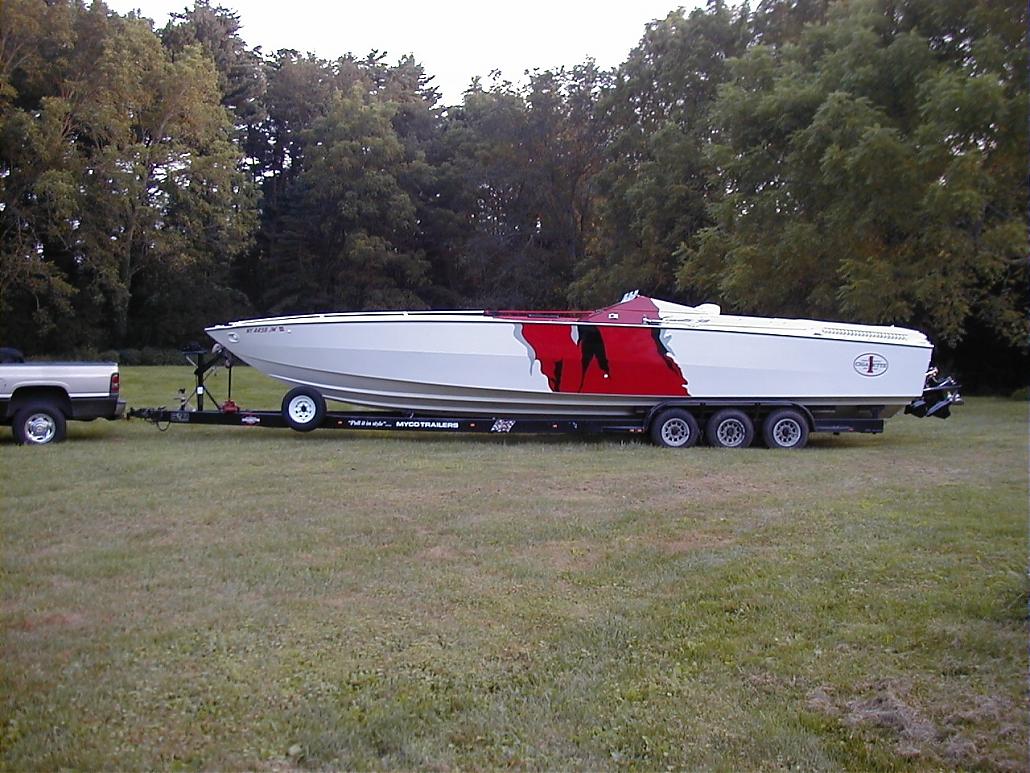

Old 02-26-2008 | 02:00 PM
TomFTM's Avatar
Joined: Dec 2000
Posts: 2,366
Likes: 88
From: Glen Cove ,NY 11542
here is a picture of the inside of the hatch.. Tom
Attached Thumbnails I need a raised engine hatch for a 38 flat deck-cig-hatch.jpg
TomFTM is offline
Old 02-26-2008 | 02:11 PM
TomFTM's Avatar
Joined: Dec 2000
Posts: 2,366
Likes: 88
a couple of more picts.
Attached Thumbnails I need a raised engine hatch for a 38 flat deck-better-hatch-pict.jpg   I need a raised engine hatch for a 38 flat deck-int-cig.jpg   I need a raised engine hatch for a 38 flat deck-cig-side.jpg

Old 02-26-2008 | 05:46 PM
Joined: Jul 2006
Posts: 83
From: Stafford VA
Thanks Tom!! Thats looks great!! I appreciate the help!! I think thats what I'm going to do.
Thanks, everyone!!
Mick
